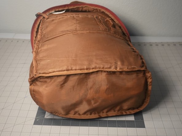

      • Turn the backpack inside out.
    2. Backpack Base Replacement: crwdns2935265:02crwdnd2935265:01crwdnd2935265:01crwdne2935265:0
      • Seam rip the binding along the bottom rectangle of the backpack.
      • Discard the ripped panel of burlap.
      • Make sure to set aside the lining fabric before discarding the burlap.

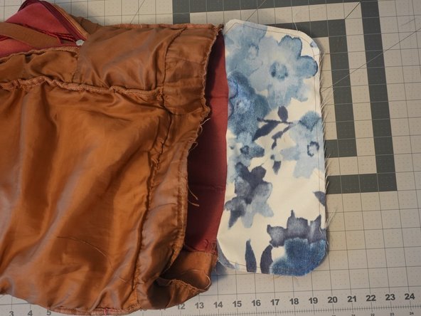

      • Iron the base panel of the polyester lining fabric.
      • Place the lining fabric on top of the desired fabric.
      • Using a ruler and rotary cutter, cut an identical rectangle.
      • Carefully round the corners of your desired fabric rectangle to match the shape of the liner.
      • Use caution when ironing the base panel.

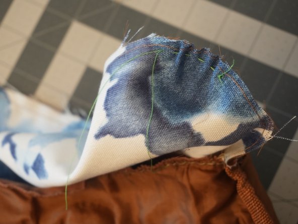

      • Make note of how much larger the fabric base is in comparison to the remaining 3 sides of the backpack.
      • Using a contrasting-colored thread, hand-sew along the corners of the base fabric.
      • Tighten the contrasting threads to bunch up the corners until they fit snug into the corners of the backpack.
      • Pin the remaining 3 sides of the base with to the 3 sides of the backpack.

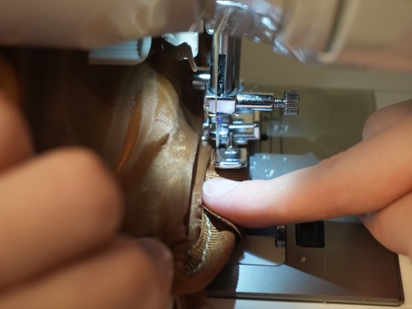

    7. Backpack Base Replacement: crwdns2935265:07crwdnd2935265:01crwdnd2935265:03crwdne2935265:0 Backpack Base Replacement: crwdns2935265:07crwdnd2935265:02crwdnd2935265:03crwdne2935265:0 Backpack Base Replacement: crwdns2935265:07crwdnd2935265:03crwdnd2935265:03crwdne2935265:0
      • Sew along the remaining three sides.
      • Be extra careful around the corners to avoid any hard creases or folds.
      • Seam-rip the contrasting color thread.
      • Trim down any fabric that exceeds 1/4" seam allowance, particularly around the corners.

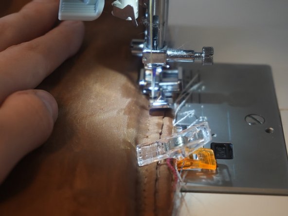

    9. Backpack Base Replacement: crwdns2935265:09crwdnd2935265:01crwdnd2935265:03crwdne2935265:0 Backpack Base Replacement: crwdns2935265:09crwdnd2935265:02crwdnd2935265:03crwdne2935265:0 Backpack Base Replacement: crwdns2935265:09crwdnd2935265:03crwdnd2935265:03crwdne2935265:0
      • Starting with the pinned end of the binding, carefully sew about 1/10" away from the end of the binding.
      • When you reach the loose end of the binding, connect the end that you already sewed with the loose end.
      • Sew both ends together.
