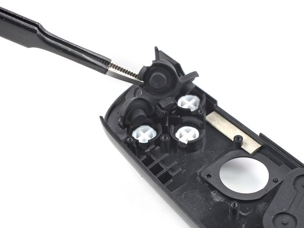

    1. Backbone One Face Buttons Replacement, Remove the rubber cover: crwdns2935265:013crwdnd2935265:01crwdnd2935265:03crwdne2935265:0 Backbone One Face Buttons Replacement, Remove the rubber cover: crwdns2935265:013crwdnd2935265:02crwdnd2935265:03crwdne2935265:0 Backbone One Face Buttons Replacement, Remove the rubber cover: crwdns2935265:013crwdnd2935265:03crwdnd2935265:03crwdne2935265:0
      • Use a pair of blunt nose tweezers to remove the rubber cover which is placed over the face buttons.
    2. Backbone One Face Buttons Replacement, Remove the face buttons: crwdns2935265:014crwdnd2935265:01crwdnd2935265:03crwdne2935265:0 Backbone One Face Buttons Replacement, Remove the face buttons: crwdns2935265:014crwdnd2935265:02crwdnd2935265:03crwdne2935265:0 Backbone One Face Buttons Replacement, Remove the face buttons: crwdns2935265:014crwdnd2935265:03crwdnd2935265:03crwdne2935265:0
      • Use a pair of tweezers to remove the face buttons.
