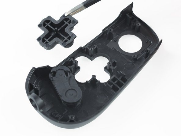

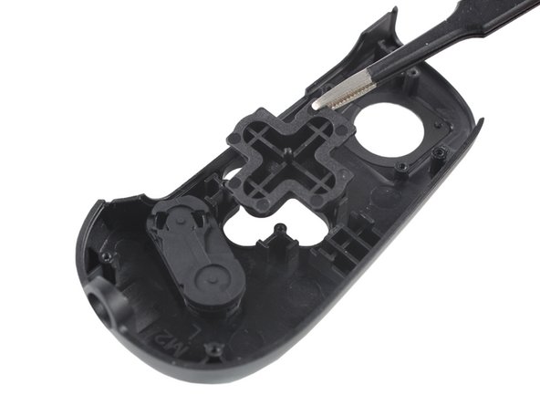

    1. Backbone One Direction Pad Replacement, Remove the direction pad: crwdns2935265:012crwdnd2935265:01crwdnd2935265:03crwdne2935265:0 Backbone One Direction Pad Replacement, Remove the direction pad: crwdns2935265:012crwdnd2935265:02crwdnd2935265:03crwdne2935265:0 Backbone One Direction Pad Replacement, Remove the direction pad: crwdns2935265:012crwdnd2935265:03crwdnd2935265:03crwdne2935265:0
      • Use a pair of blunt nose tweezers to remove the direction pad.
