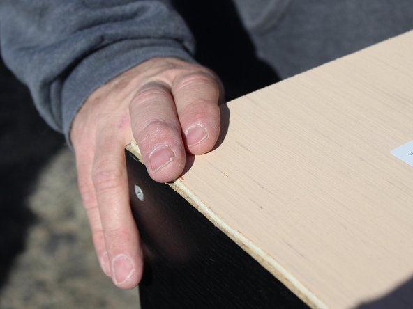

    • You will need to put the bookshelf back together by holding the sides together.
    • Drill new holes to insert new screws to reinforce the shelf. Use a 1/8 inch drill bit.
    • Put screws into the freshly made holes with 1/8 by 1 inch wood screws to bring it together.

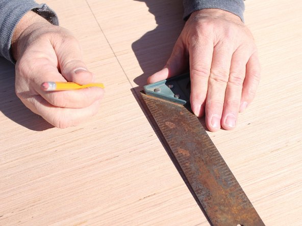

    • Now that the base of the bookshelf is back together, we will need to measure out the size of board needed for the new backing.

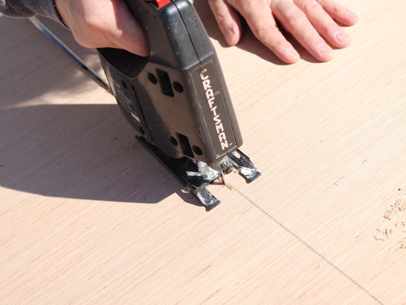

    • Use the measuring tape and the square ruler to measure out the specific size you need. Use a pencil to draw the lines out so you can saw the piece out with precision.
    • Use the jig saw to cut the piece of plywood out following the lines you just drew.

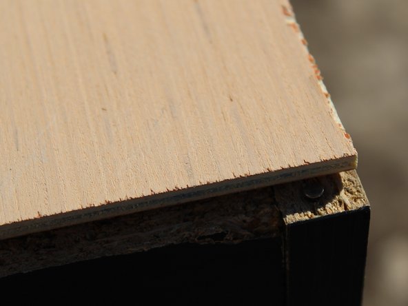

    • Line your new piece of plywood that you just cut, up with the back of the bookshelf.
    • Make sure that the corners are lined up so that as you hammer in the nails it stays lined up and even.

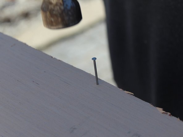

    • Start from the top and work your way down each side when putting the nails in so the board doesn't bow.
    • Use 2d penny nails and hammer them in along all four sides.
    • Five nails on each of the four sides is all you will need.
