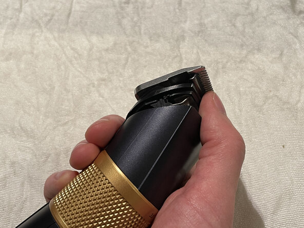

  1. Babyliss Lithium Performance (E986E) Teardown, Remove clipper head: crwdns2935265:01crwdnd2935265:01crwdnd2935265:01crwdne2935265:0
    • Push up from the blade side to remove.

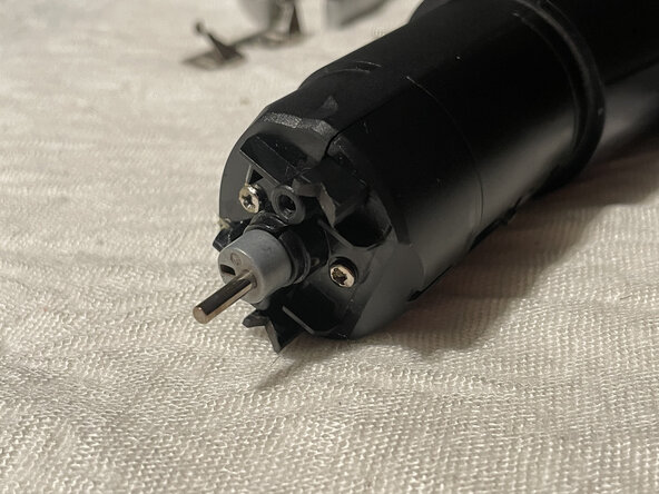

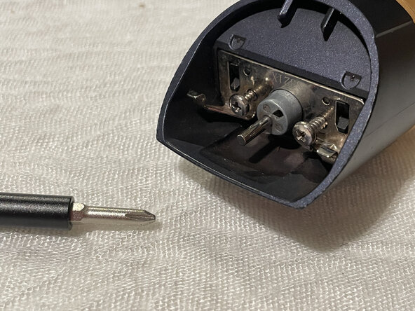

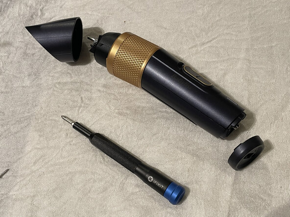

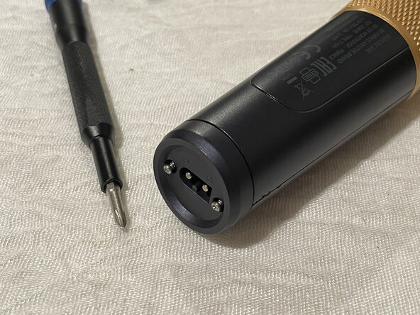

  2. Babyliss Lithium Performance (E986E) Teardown, Remove end caps: crwdns2935265:02crwdnd2935265:01crwdnd2935265:03crwdne2935265:0 Babyliss Lithium Performance (E986E) Teardown, Remove end caps: crwdns2935265:02crwdnd2935265:02crwdnd2935265:03crwdne2935265:0 Babyliss Lithium Performance (E986E) Teardown, Remove end caps: crwdns2935265:02crwdnd2935265:03crwdnd2935265:03crwdne2935265:0
    • Use your PH1 screwdriver to remove the 4 visible screws holding down both end caps (2 screws per cap).

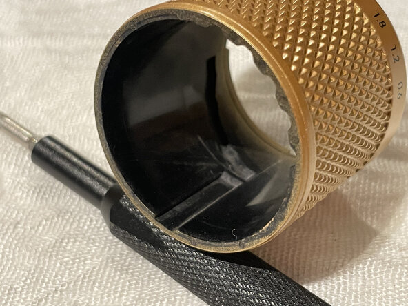

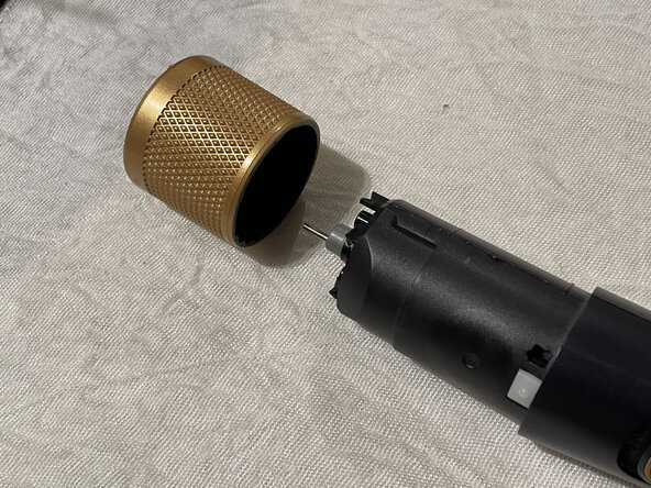

  3. Babyliss Lithium Performance (E986E) Teardown, Remove trimming length selector ring: crwdns2935265:03crwdnd2935265:01crwdnd2935265:03crwdne2935265:0 Babyliss Lithium Performance (E986E) Teardown, Remove trimming length selector ring: crwdns2935265:03crwdnd2935265:02crwdnd2935265:03crwdne2935265:0 Babyliss Lithium Performance (E986E) Teardown, Remove trimming length selector ring: crwdns2935265:03crwdnd2935265:03crwdnd2935265:03crwdne2935265:0
    • Put the selector on "3 mm" and pull it off the clipper (this requires some force)
    • If you look at the second picture, you can see that under the guide that actually selects the trimming length, there is a vertical indent going straight down and atop it a bump between it and the length guide.
    • The reason the ring is hard to pull out is because of this little bump.
    • The vertical indent will also help to reassemble the clippers when you're done.

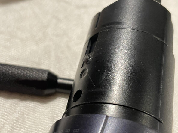

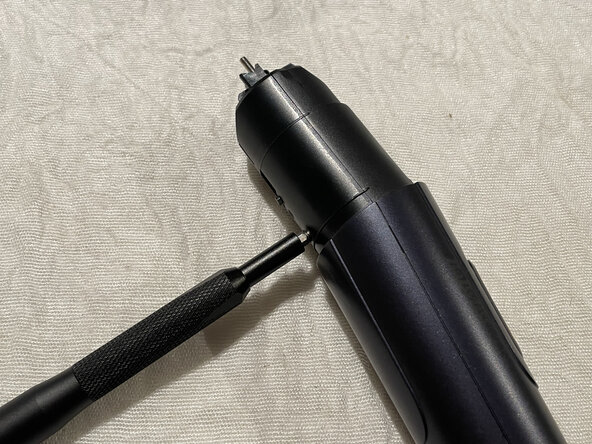

  4. Babyliss Lithium Performance (E986E) Teardown, Remove structural and motor screws: crwdns2935265:04crwdnd2935265:01crwdnd2935265:02crwdne2935265:0 Babyliss Lithium Performance (E986E) Teardown, Remove structural and motor screws: crwdns2935265:04crwdnd2935265:02crwdnd2935265:02crwdne2935265:0
    • Use your PH1 screwdriver to remove the screw holding the main body parts together as well as the 2 screws on top holding the motor in place.

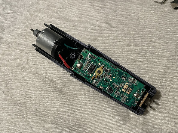

  5. Babyliss Lithium Performance (E986E) Teardown, Prying open + replacement parts: crwdns2935265:05crwdnd2935265:01crwdnd2935265:03crwdne2935265:0 Babyliss Lithium Performance (E986E) Teardown, Prying open + replacement parts: crwdns2935265:05crwdnd2935265:02crwdnd2935265:03crwdne2935265:0 Babyliss Lithium Performance (E986E) Teardown, Prying open + replacement parts: crwdns2935265:05crwdnd2935265:03crwdnd2935265:03crwdne2935265:0
    • Pry the body apart starting from the bottom, you can use pry tools or a flat head screwdriver to get some leverage (though the flat head will likely damage your clipper a bit).

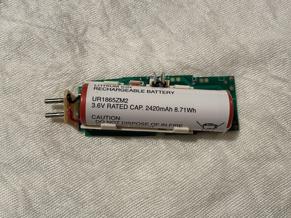

    • This will expose the insides of the clipper. The battery is attached under the PCB.
    • To remove the PCB, pull the tabs holding it in place near the bottom and it will slide out. The motor was unscrewed in step 4 and will slide out as well.
    • The battery is a standard 3.6V Lithium-Ion battery, you can find them for cheap online.

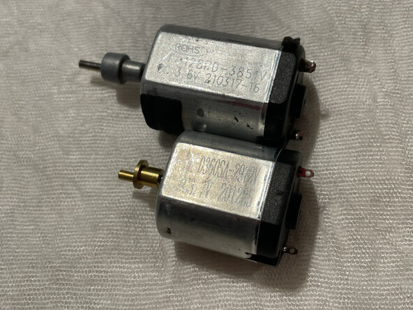

    • The DC motor is a FF 128PD and the clipper end can be removed. This motor is impossible to find online but you can buy an FF360 instead, it's slightly shorter but the screw spacing is the same and fits this razor.
