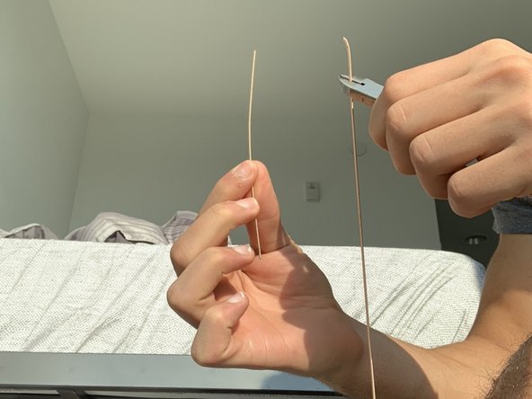

  6. Baby Taylor Guitar String Replacement: crwdns2935265:06crwdnd2935265:01crwdnd2935265:02crwdne2935265:0 Baby Taylor Guitar String Replacement: crwdns2935265:06crwdnd2935265:02crwdnd2935265:02crwdne2935265:0
    • Cut the excess string with a plier.
    • Cut the string around 1.5 inches over the desired tuning pin. (Recommended by Taylor Guitars)
