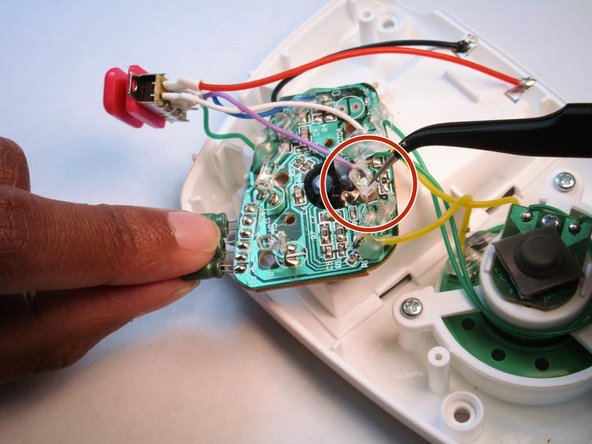

    5. Baby Einstein Take Along Tunes LED  Replacement: crwdns2935265:05crwdnd2935265:01crwdnd2935265:01crwdne2935265:0
      • Using a screwdriver loosen the screws on the lights panel.
    6. Baby Einstein Take Along Tunes LED  Replacement: crwdns2935265:06crwdnd2935265:01crwdnd2935265:01crwdne2935265:0
      • Using a plastic opening tool pop the light panel off. Be careful as to not rip any of the wires from the panel.
    7. Baby Einstein Take Along Tunes LED  Replacement: crwdns2935265:07crwdnd2935265:01crwdnd2935265:02crwdne2935265:0 Baby Einstein Take Along Tunes LED  Replacement: crwdns2935265:07crwdnd2935265:02crwdnd2935265:02crwdne2935265:0
      • Carefully pull the LED lights off with a pair of tweezers. Once off, put in and connect a replacement.
