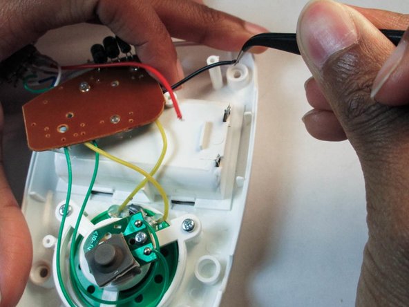

  9. Baby Einstein Take Along Tunes Battery Socket Replacement: crwdns2935265:09crwdnd2935265:01crwdnd2935265:01crwdne2935265:0
    • With the precision tweezers, straighten the metal connectors to remove the terminals from the other side.

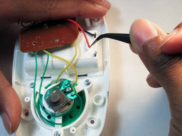

  10. Baby Einstein Take Along Tunes Battery Socket Replacement: crwdns2935265:010crwdnd2935265:01crwdnd2935265:02crwdne2935265:0 Baby Einstein Take Along Tunes Battery Socket Replacement: crwdns2935265:010crwdnd2935265:02crwdnd2935265:02crwdne2935265:0
    • Sever the red wire from the metal connector with the precision tweezers.
  11. Baby Einstein Take Along Tunes Battery Socket Replacement: crwdns2935265:011crwdnd2935265:01crwdnd2935265:02crwdne2935265:0 Baby Einstein Take Along Tunes Battery Socket Replacement: crwdns2935265:011crwdnd2935265:02crwdnd2935265:02crwdne2935265:0
    • Sever the black wire from the metal connector with the precision tweezers.

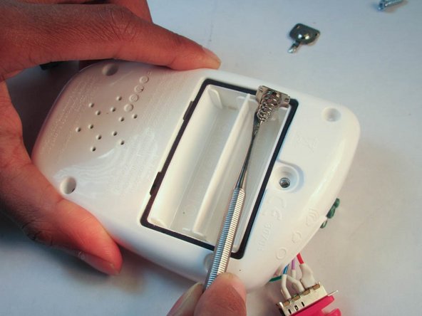

  12. Baby Einstein Take Along Tunes Battery Socket Replacement: crwdns2935265:012crwdnd2935265:01crwdnd2935265:02crwdne2935265:0 Baby Einstein Take Along Tunes Battery Socket Replacement: crwdns2935265:012crwdnd2935265:02crwdnd2935265:02crwdne2935265:0
    • Flip the device on its face and remove the battery terminals with a metal spudger.
