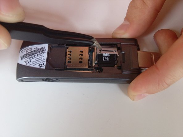

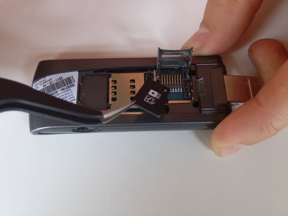

    1. BRCK v1 Modem MicroSD Card Replacement, Modem MicroSD Card: crwdns2935265:09crwdnd2935265:01crwdnd2935265:03crwdne2935265:0 BRCK v1 Modem MicroSD Card Replacement, Modem MicroSD Card: crwdns2935265:09crwdnd2935265:02crwdnd2935265:03crwdne2935265:0 BRCK v1 Modem MicroSD Card Replacement, Modem MicroSD Card: crwdns2935265:09crwdnd2935265:03crwdnd2935265:03crwdne2935265:0
      • With your tweezers, slide the metal face plate to release the locking mechanism.
      • Lift the face plate and carefully remove the microSD card.
