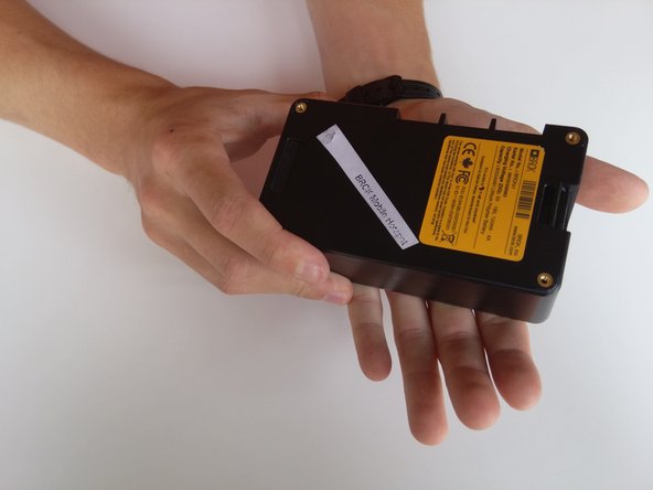

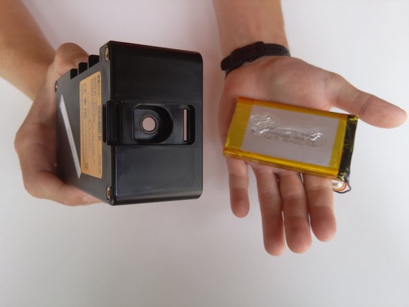

    1. BRCK v1 Battery Replacement, Battery: crwdns2935265:011crwdnd2935265:01crwdnd2935265:03crwdne2935265:0 BRCK v1 Battery Replacement, Battery: crwdns2935265:011crwdnd2935265:02crwdnd2935265:03crwdne2935265:0 BRCK v1 Battery Replacement, Battery: crwdns2935265:011crwdnd2935265:03crwdnd2935265:03crwdne2935265:0
      • Flip device upside down. Hold the device and tap into your other hand with varying force to remove battery.
      • This may take a few tries to remove the battery.
