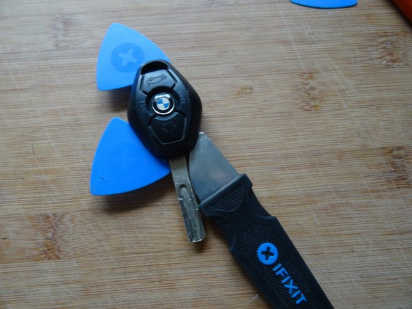

    • The two halves of the casing are glued together. Separate the seam between the upper and lower casing with a sharp utility knife.
    • The process is tricky and time-consuming, cutting again and again around the key. Work slowly and patiently.
    • Don't cut deeper than 3 millimeters, so you don't come into contact with the circuit board.
  2. BMW X3 E83 Key Battery replacement: crwdns2935265:03crwdnd2935265:01crwdnd2935265:03crwdne2935265:0 BMW X3 E83 Key Battery replacement: crwdns2935265:03crwdnd2935265:02crwdnd2935265:03crwdne2935265:0 BMW X3 E83 Key Battery replacement: crwdns2935265:03crwdnd2935265:03crwdnd2935265:03crwdne2935265:0
    • When the seam is open wide enough, slide a pick inside.
    • Then separate the casings with an appropriate tool.

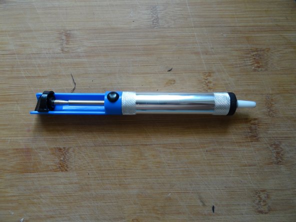

    Desoldering Pump
    $3.99
    • Desolder the battery from the solder pads marked in red.
    • Use a desoldering pump or desoldering wick.
    • Lift the battery out carefully.
