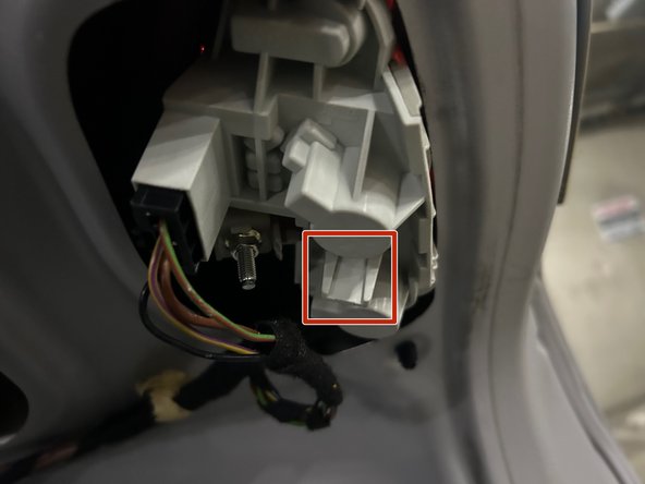

  3. BMW 325i e90 Inner Tail Light Bulb Replacement: crwdns2935265:03crwdnd2935265:01crwdnd2935265:02crwdne2935265:0 BMW 325i e90 Inner Tail Light Bulb Replacement: crwdns2935265:03crwdnd2935265:02crwdnd2935265:02crwdne2935265:0
    • With the tail light bulb socket exposed, you'll need to first disconnect the wiring and then squeeze the plastic clip to release the entire bulb socket.

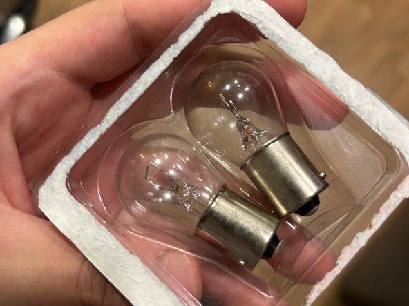

  4. BMW 325i e90 Inner Tail Light Bulb Replacement: crwdns2935265:04crwdnd2935265:01crwdnd2935265:02crwdne2935265:0 BMW 325i e90 Inner Tail Light Bulb Replacement: crwdns2935265:04crwdnd2935265:02crwdnd2935265:02crwdne2935265:0
    • Once you remove the bulb socket simply remove the faulty bulb by twisting and pulling, then replace it with a new one. Place the socket back in and listen for it to click.
Once the new bulb is installed and the bulb housing is back in place, reconnect the wiring. Now simply line up the trunk trim panel and insert the studs in their corresponding holes to finish your bulb replacement.
