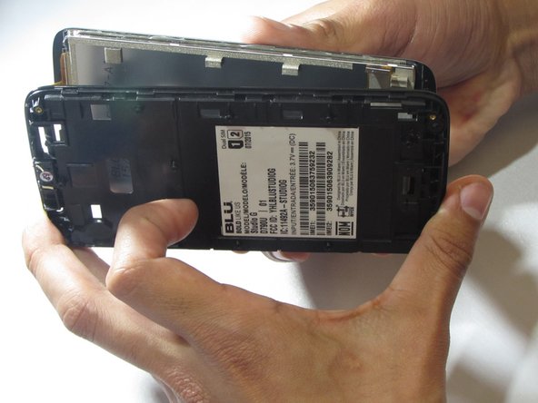

    1. BLU Studio G Screen Replacement, Screen: crwdns2935265:09crwdnd2935265:01crwdnd2935265:01crwdne2935265:0
      • Turn the phone over after detaching the connectors that were attached to the motherboard
      • Carefully pry between the screen and the bevel with precision tweezers lifting slowly separating the screen.
      • Use of another thin tool will help support the lifting

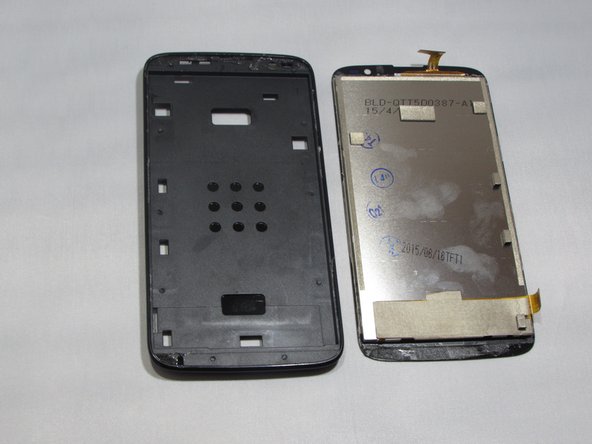

    2. BLU Studio G Screen Replacement: crwdns2935265:010crwdnd2935265:01crwdnd2935265:03crwdne2935265:0 BLU Studio G Screen Replacement: crwdns2935265:010crwdnd2935265:02crwdnd2935265:03crwdne2935265:0 BLU Studio G Screen Replacement: crwdns2935265:010crwdnd2935265:03crwdnd2935265:03crwdne2935265:0
      • Insert the metal spudger between the screen and the frame, using the blue plastic tool as a brace to prevent the screen from reattaching to the frame.
      • To fully remove the screen from the frame, repeat the previous step around the entire perimeter of the device.
      • Carefully remove the screen.
