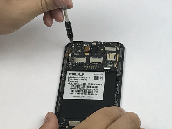

  6. BLU Studio 5.5 Motherboard Replacement, Motherboard: crwdns2935265:06crwdnd2935265:01crwdnd2935265:03crwdne2935265:0 BLU Studio 5.5 Motherboard Replacement, Motherboard: crwdns2935265:06crwdnd2935265:02crwdnd2935265:03crwdne2935265:0 BLU Studio 5.5 Motherboard Replacement, Motherboard: crwdns2935265:06crwdnd2935265:03crwdnd2935265:03crwdne2935265:0
    • Locate the motherboard that is above where the battery was removed.
    • Remove the three screws holding down the motherboard to the phone.

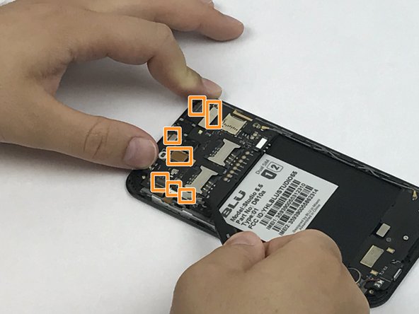

    • Locate all 7 flex cable connectors that are attached to the motherboard.

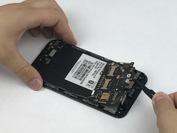

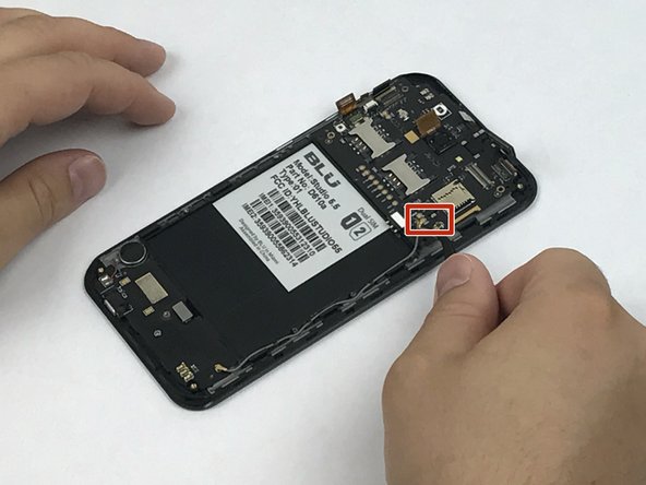

    • Use tweezers to carefully grasp and unhook all 7 flex cable connectors.
    • With the same tweezers, pry off the cable clasp that connects the motherboard to the sub PCBA.
    • Once the motherboard is disconnected from all components, use the tweezers or your fingers to remove it from the phone assembly.
    • Use the Anti-Static Wrist Strap to eliminate the possibility of introducing a static force that may damage the motherboard components.
