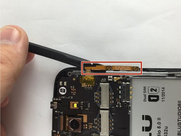

  6. BLU Studio 5.0 II Volume Button Replacement, Volume Button: crwdns2935265:06crwdnd2935265:01crwdnd2935265:02crwdne2935265:0 BLU Studio 5.0 II Volume Button Replacement, Volume Button: crwdns2935265:06crwdnd2935265:02crwdnd2935265:02crwdne2935265:0
    • Locate the volume button on the right side of the phone after removing back case.
    • Using a spudger carefully wedge between button and phone and carefully pry away from the phone.
    • Once removed the yellow buttons will be visible.
