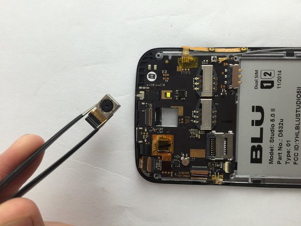

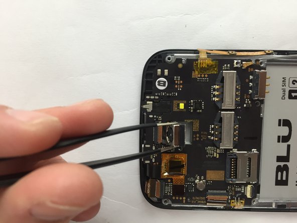

  6. BLU Studio 5.0 II Rear Camera Replacement, Rear Camera: crwdns2935265:06crwdnd2935265:01crwdnd2935265:03crwdne2935265:0 BLU Studio 5.0 II Rear Camera Replacement, Rear Camera: crwdns2935265:06crwdnd2935265:02crwdnd2935265:03crwdne2935265:0 BLU Studio 5.0 II Rear Camera Replacement, Rear Camera: crwdns2935265:06crwdnd2935265:03crwdnd2935265:03crwdne2935265:0
    • Locate the camera, which is centered on the upper part of the motherboard.
    • Use tweezers to lift the camera slowly.
    • Carefully pull the camera out of the motherboard.
