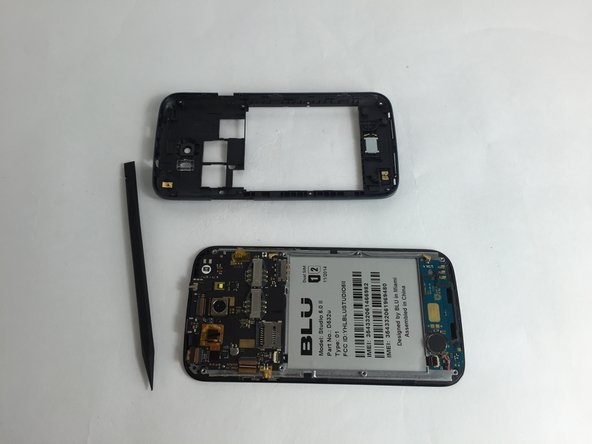

This guide will teach you how to replace the power button on your BLU Studio 5.0 II phone.
    1. BLU Studio 5.0 II Power Button Replacement, Battery: crwdns2935265:01crwdnd2935265:01crwdnd2935265:01crwdne2935265:0
      • Turn off your phone before disassembling the device.
      • Locate the small opening on the bottom corner of the back case.
    2. BLU Studio 5.0 II Power Button Replacement: crwdns2935265:02crwdnd2935265:01crwdnd2935265:02crwdne2935265:0 BLU Studio 5.0 II Power Button Replacement: crwdns2935265:02crwdnd2935265:02crwdnd2935265:02crwdne2935265:0
      • Use your finger to open the back case by slowly pulling it on the open slot.
      • Once the case is lifted on the corner, slide your finger along the edge of the phone to remove the rest of the case.
    3. BLU Studio 5.0 II Power Button Replacement: crwdns2935265:03crwdnd2935265:01crwdnd2935265:03crwdne2935265:0 BLU Studio 5.0 II Power Button Replacement: crwdns2935265:03crwdnd2935265:02crwdnd2935265:03crwdne2935265:0 BLU Studio 5.0 II Power Button Replacement: crwdns2935265:03crwdnd2935265:03crwdnd2935265:03crwdne2935265:0
      • Locate the opening slot at the bottom of the battery.
      • Use your finger to lift the battery and remove it from the case.
    1. BLU Studio 5.0 II Power Button Replacement, Back Case: crwdns2935265:04crwdnd2935265:01crwdnd2935265:01crwdne2935265:0
      • Locate the four 3mm screws on each side of the back panel.
      • Use a Phillips #00 screwdriver to remove the eight screws.
    2. BLU Studio 5.0 II Power Button Replacement: crwdns2935265:05crwdnd2935265:01crwdnd2935265:03crwdne2935265:0 BLU Studio 5.0 II Power Button Replacement: crwdns2935265:05crwdnd2935265:02crwdnd2935265:03crwdne2935265:0 BLU Studio 5.0 II Power Button Replacement: crwdns2935265:05crwdnd2935265:03crwdnd2935265:03crwdne2935265:0
      • Carefully use a spudger to start opening the back case by inserting it between the black and blue lines on the side of the phone.
      • With the help of your fingers, continue to remove the back case by sliding it through the opening.

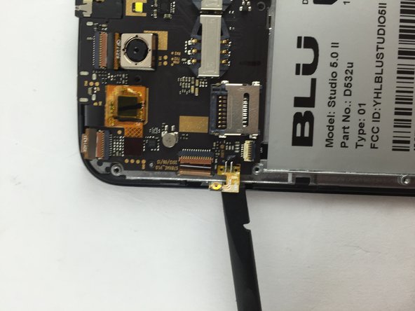

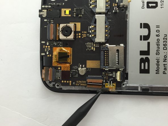

    1. BLU Studio 5.0 II Power Button Replacement, Power Button: crwdns2935265:06crwdnd2935265:01crwdnd2935265:03crwdne2935265:0 BLU Studio 5.0 II Power Button Replacement, Power Button: crwdns2935265:06crwdnd2935265:02crwdnd2935265:03crwdne2935265:0 BLU Studio 5.0 II Power Button Replacement, Power Button: crwdns2935265:06crwdnd2935265:03crwdnd2935265:03crwdne2935265:0
      • Locate the power button on the left side of the motherboard.
      • Using a spudger or a pair of tweezers, carefully remove the power button yellow film attached to the motherboard.
