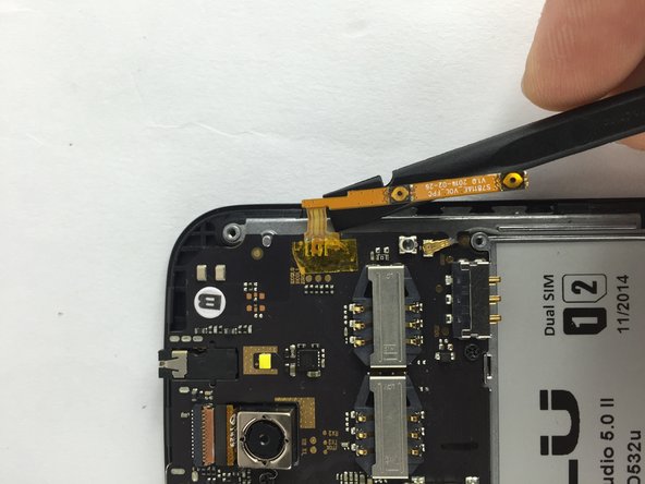

    • Locate the following adhesive buttons on the right and left side of the motherboard. These are the volume and power buttons.
    • Use a spudger to carefully separate them from the circuit board.

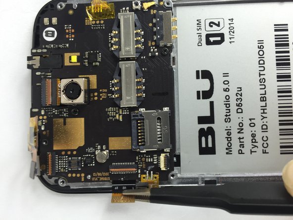

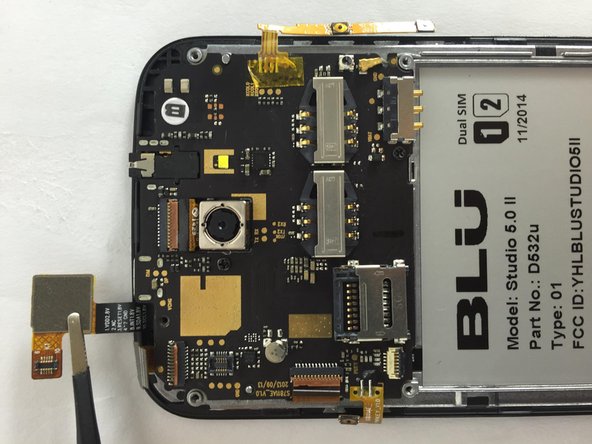

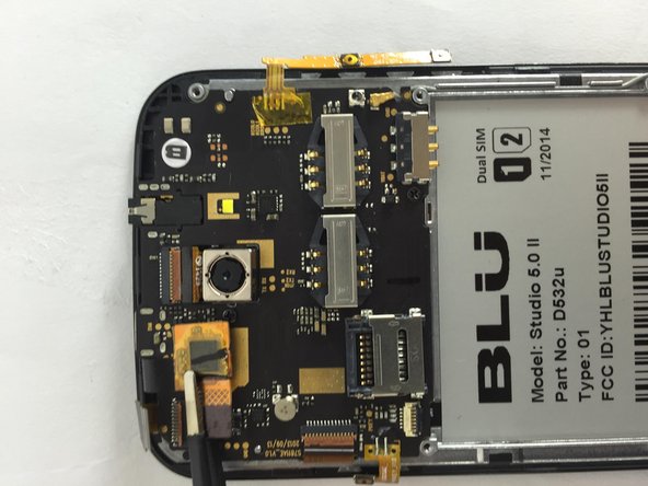

    • Locate these two ZIF connectors on the top and left side of the motherboard.
    • Use a spudger to flip up and unlock the black tab on the connector.
    • Use tweezers to pull the ribbon cables out of their connectors.

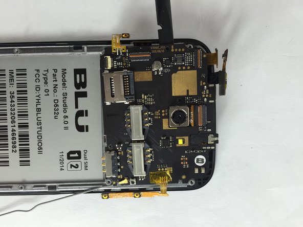

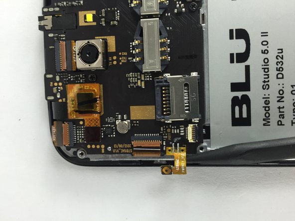

  8. BLU Studio 5.0 II Motherboard Replacement: crwdns2935265:08crwdnd2935265:01crwdnd2935265:03crwdne2935265:0 BLU Studio 5.0 II Motherboard Replacement: crwdns2935265:08crwdnd2935265:02crwdnd2935265:03crwdne2935265:0 BLU Studio 5.0 II Motherboard Replacement: crwdns2935265:08crwdnd2935265:03crwdnd2935265:03crwdne2935265:0
    • Locate the indicated connector on the top side of the motherboard.
    • Use a pair of tweezers to gently lift the connector from the circuit board.

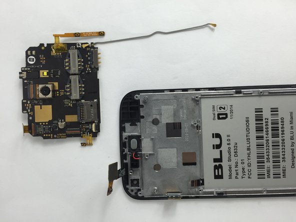

  9. BLU Studio 5.0 II Motherboard Replacement: crwdns2935265:09crwdnd2935265:01crwdnd2935265:03crwdne2935265:0 BLU Studio 5.0 II Motherboard Replacement: crwdns2935265:09crwdnd2935265:02crwdnd2935265:03crwdne2935265:0 BLU Studio 5.0 II Motherboard Replacement: crwdns2935265:09crwdnd2935265:03crwdnd2935265:03crwdne2935265:0
    • Remove the three 3mm screws on the motherboard using a Phillips #00 screwdriver.
    • Use a spudger or tweezers to carefully lift and remove the motherboard.
