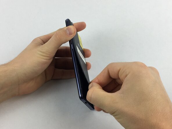

    • Turn the device off by holding down the power button for up to 5 seconds and then tapping the "Power off" button on the screen.
    • Remove the rear cover using your hands at the lip on the device back cover. No tools required.

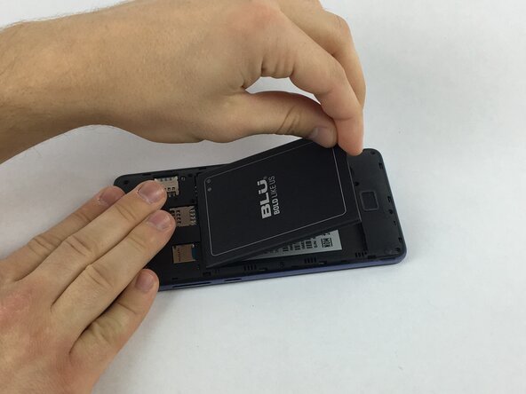

    • Remove the battery by lifting the lower edge of the battery up first.

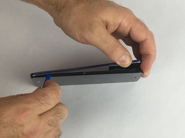

    • Firmly press the prying tool into the gap between the front glass and rear plate. This gap is located on all sides of the phone.
    • Run the prying tool around the entire phone separating the rear plate from the frame.

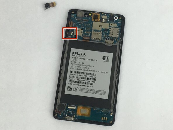

    • Gently remove the tape covering the volume control buttons. The tape is located near the top left of the cavity for the battery.
    • Replace the component and reapply the tape over the buttons.

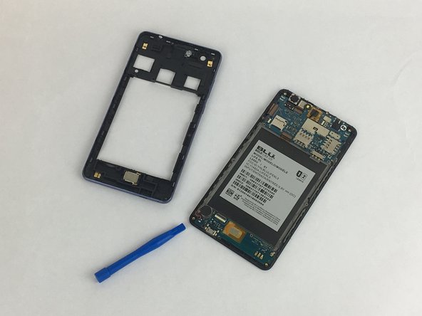

  5. BLU Life XL Headphone Port Replacement, Motherboard: crwdns2935265:05crwdnd2935265:01crwdnd2935265:02crwdne2935265:0 BLU Life XL Headphone Port Replacement, Motherboard: crwdns2935265:05crwdnd2935265:02crwdnd2935265:02crwdne2935265:0
    • Remove the two 12x3mm screws using the Phillips #000 screwdriver.
    • Remove the ribbon cables.
