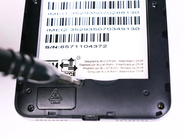

      • Flip the phone over so that the screen is facing down.
      • Slide the opening tool between the micro-USB port and the back cover.
      • Use the opening tool to create a gap.
    2. BLU Life X8 Front Camera Replacement: crwdns2935265:02crwdnd2935265:01crwdnd2935265:01crwdne2935265:0
      • Use your thumb to pry off the back panel once the gap is large enough.
    3. BLU Life X8 Front Camera Replacement: crwdns2935265:03crwdnd2935265:01crwdnd2935265:01crwdne2935265:0
      • Once the back panel is off, locate the indent at the bottom of the battery.
      • Use your thumb to slip the battery out of the case.

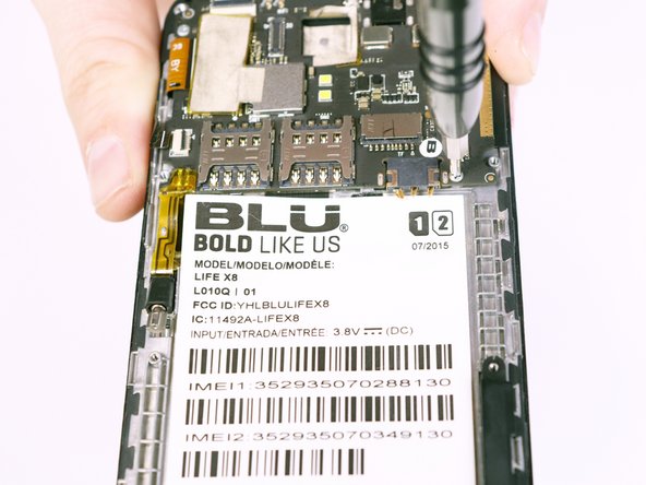

      • Use the Phillips #00 bit to undo the nine 1.5mm screws from the back of the device.

      • Use the Phillips #00 Phillips bit to undo the two 1.5mm screws from the motherboard.
