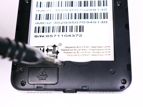

      • Once the back panel is off, locate the indent at the bottom of the battery.
      • Use your thumb to slip the battery out of the case.
