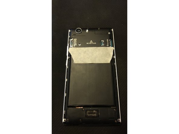

  3. BLU Life One (2015) Teardown, Remove back sticker: crwdns2935265:03crwdnd2935265:01crwdnd2935265:03crwdne2935265:0 BLU Life One (2015) Teardown, Remove back sticker: crwdns2935265:03crwdnd2935265:02crwdnd2935265:03crwdne2935265:0 BLU Life One (2015) Teardown, Remove back sticker: crwdns2935265:03crwdnd2935265:03crwdnd2935265:03crwdne2935265:0
    • Above the battery there is a sticker that must be removed. Use a screwdriver or pry tool to get under the sticker and peel it off. (I use a piece of tape because mine has been thrown away.)
    • NOTE: Tape does not have to be replaced in order for phone to work.

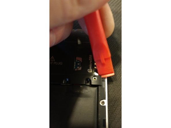

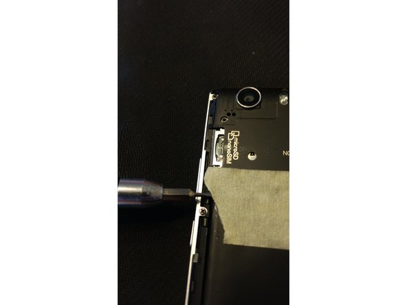

  4. BLU Life One (2015) Teardown, Upper backplate removal: crwdns2935265:04crwdnd2935265:01crwdnd2935265:03crwdne2935265:0 BLU Life One (2015) Teardown, Upper backplate removal: crwdns2935265:04crwdnd2935265:02crwdnd2935265:03crwdne2935265:0 BLU Life One (2015) Teardown, Upper backplate removal: crwdns2935265:04crwdnd2935265:03crwdnd2935265:03crwdne2935265:0
    • There will be 4 black screws you must remove from the plate that says NO HOT PLUG.
    • There is also 1 white screw. Make sure to only put this screw back in the spot from which it came. (Above the MicroSIM slot)

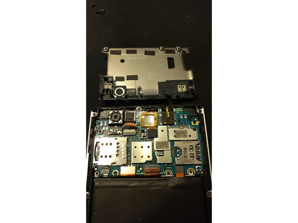

    • Using a pry tool, pry up from the lower right corner to release the snap connectors.
    • Keep prying the plate up and over the rear camera module to fully remove it.
    • 4 Black Philips Screws
    • 1 White Philips screw. Do not put this screw anywhere else but here!

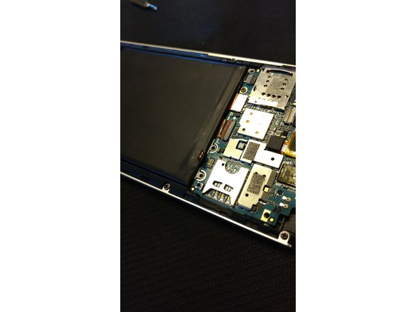

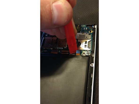

  5. BLU Life One (2015) Teardown, Battery removal: crwdns2935265:05crwdnd2935265:01crwdnd2935265:03crwdne2935265:0 BLU Life One (2015) Teardown, Battery removal: crwdns2935265:05crwdnd2935265:02crwdnd2935265:03crwdne2935265:0 BLU Life One (2015) Teardown, Battery removal: crwdns2935265:05crwdnd2935265:03crwdnd2935265:03crwdne2935265:0
    • As the guts of the phone are now exposed, the square ribbon connector on the bottom rightmost of the mainboard needs to be pried up. This will remove the battery from the circuit.
    • A few people (Myself Included) have had an issue with this phone where the from notification LED will come on and the screen will stay black. Even if you hold down power for an hour it will still be the same. By fully removing power this way you will solve this problem.
    • Battery Connector
