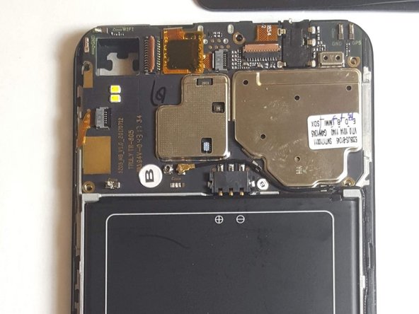

    • Identify the back-panel camera in the left -hand corner of the open device. (Figure 1)

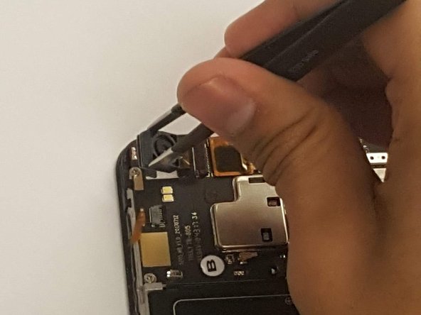

    • Use the Plastic Pry Tool to carefully to lift the tab on the right-hand side of the connector.
    • Carefully remove camera from housing using a pair of tweezers.
