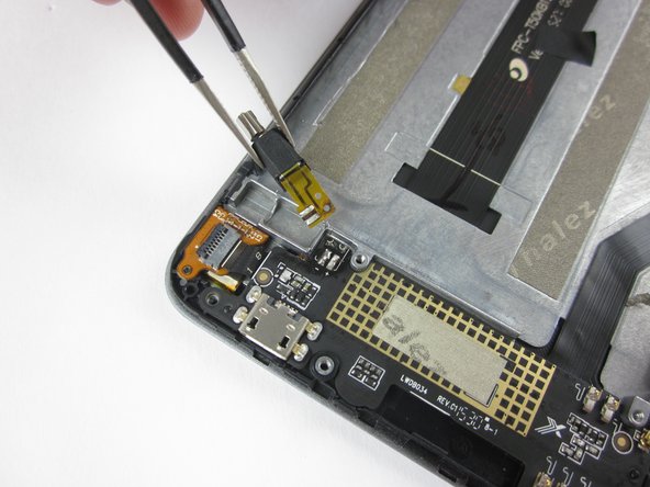

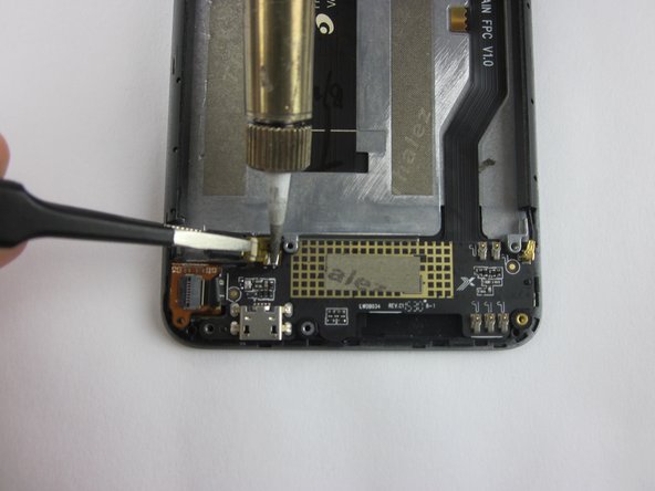

  4. BLU Energy X Vibration Motor Replacement, Vibration Motor: crwdns2935265:04crwdnd2935265:01crwdnd2935265:03crwdne2935265:0 BLU Energy X Vibration Motor Replacement, Vibration Motor: crwdns2935265:04crwdnd2935265:02crwdnd2935265:03crwdne2935265:0 BLU Energy X Vibration Motor Replacement, Vibration Motor: crwdns2935265:04crwdnd2935265:03crwdnd2935265:03crwdne2935265:0
    • Remove the five 4 mm JIS J000 screws from bottom plate
    • Using a soldering iron, simultaneously heat the two soldered connections for the motor
    • When the connection is melted, use a set of tweezers to safely remove the motor
