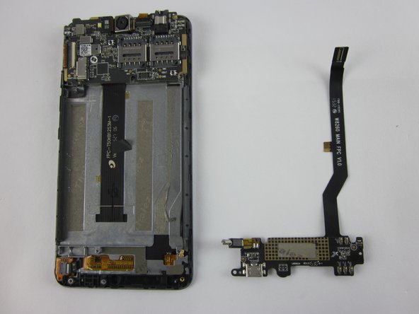

    1. BLU Energy X USB Board Replacement, USB Board: crwdns2935265:04crwdnd2935265:01crwdnd2935265:02crwdne2935265:0 BLU Energy X USB Board Replacement, USB Board: crwdns2935265:04crwdnd2935265:02crwdnd2935265:02crwdne2935265:0
      • Remove the five 4 mm JIS J000 screws from bottom plate
      • Remove the bottom casing.

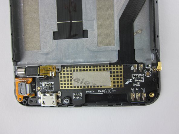

    2. BLU Energy X USB Board Replacement: crwdns2935265:05crwdnd2935265:01crwdnd2935265:02crwdne2935265:0 BLU Energy X USB Board Replacement: crwdns2935265:05crwdnd2935265:02crwdnd2935265:02crwdne2935265:0
      • Disconnect vibration motor and connector as indicated.
      • Remove motherboard.
