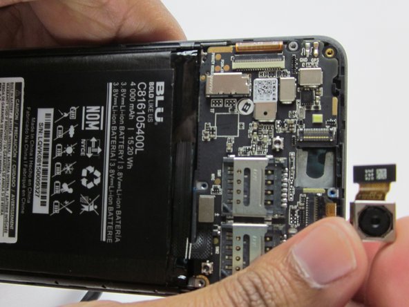

    • Pry open and remove back cover with plastic spudger.
  2. BLU Energy X Rear Facing Camera Replacement: crwdns2935265:02crwdnd2935265:01crwdnd2935265:02crwdne2935265:0 BLU Energy X Rear Facing Camera Replacement: crwdns2935265:02crwdnd2935265:02crwdnd2935265:02crwdne2935265:0
    • Remove the seven 4 mm Phillips #000 screws from top plate
    • Remove top plate
  3. BLU Energy X Rear Facing Camera Replacement: crwdns2935265:03crwdnd2935265:01crwdnd2935265:02crwdne2935265:0 BLU Energy X Rear Facing Camera Replacement: crwdns2935265:03crwdnd2935265:02crwdnd2935265:02crwdne2935265:0
    • Use plastic spudger to disconnect the camera from the motherboard
    • Remove camera
