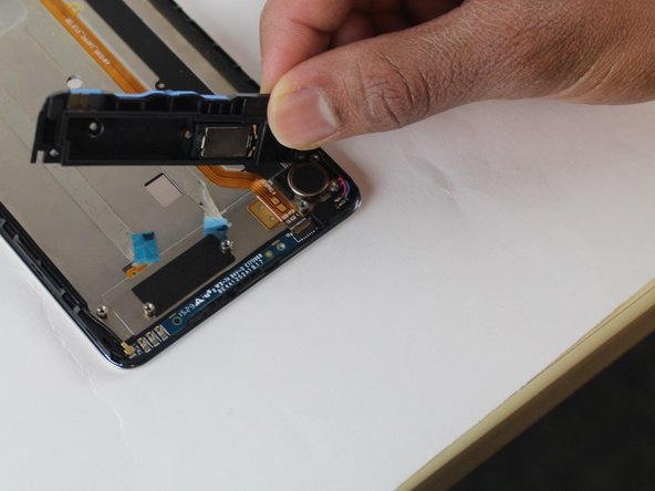

  9. BLU Energy X Plus Speaker Replacement, Speaker: crwdns2935265:09crwdnd2935265:01crwdnd2935265:01crwdne2935265:0
    • Remove the four silver screws using a J000 screwdriver bit .
    • Four silver screws, all 1.5mm in length.
  10. BLU Energy X Plus Speaker Replacement: crwdns2935265:010crwdnd2935265:01crwdnd2935265:01crwdne2935265:0
    • There will be a fifth silver screw that is covered by a white sticker. Remove this screw using the J000 screw driver head.
    • One silver screw, 1.5mm in length.
  11. BLU Energy X Plus Speaker Replacement: crwdns2935265:011crwdnd2935265:01crwdnd2935265:02crwdne2935265:0 BLU Energy X Plus Speaker Replacement: crwdns2935265:011crwdnd2935265:02crwdnd2935265:02crwdne2935265:0
    • Lift the module where the speaker is located.
