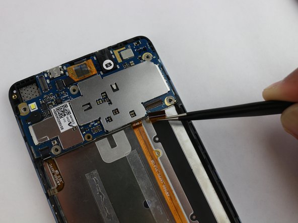

  13. BLU Energy X Plus MotherBoard Replacement: crwdns2935265:013crwdnd2935265:01crwdnd2935265:01crwdne2935265:0
    • Lift the black tab on the zero insert force connector on the lower left side of the motherboard using a small blue plastic opening tool.
  14. BLU Energy X Plus MotherBoard Replacement: crwdns2935265:014crwdnd2935265:01crwdnd2935265:01crwdne2935265:0
    • Lift the black tab on the zero insert force connector on the lower right side of the motherboard using a small blue plastic opening tool.
  15. BLU Energy X Plus MotherBoard Replacement: crwdns2935265:015crwdnd2935265:01crwdnd2935265:01crwdne2935265:0
    • Remove the yellow tape that's on the black panel using your fingers.
  16. BLU Energy X Plus MotherBoard Replacement: crwdns2935265:016crwdnd2935265:01crwdnd2935265:01crwdne2935265:0
    • Lift the black tab on the zero insert force connector on the top left side of the motherboard using a small blue plastic opening tool.
  17. BLU Energy X Plus MotherBoard Replacement: crwdns2935265:017crwdnd2935265:01crwdnd2935265:02crwdne2935265:0 BLU Energy X Plus MotherBoard Replacement: crwdns2935265:017crwdnd2935265:02crwdnd2935265:02crwdne2935265:0
    • Use a fine nose pair of tweezers to pull the ribbon cable from the zero insert force connector with little force to remove the contact connecter from the motherboard.
  18. BLU Energy X Plus MotherBoard Replacement: crwdns2935265:018crwdnd2935265:01crwdnd2935265:02crwdne2935265:0 BLU Energy X Plus MotherBoard Replacement: crwdns2935265:018crwdnd2935265:02crwdnd2935265:02crwdne2935265:0

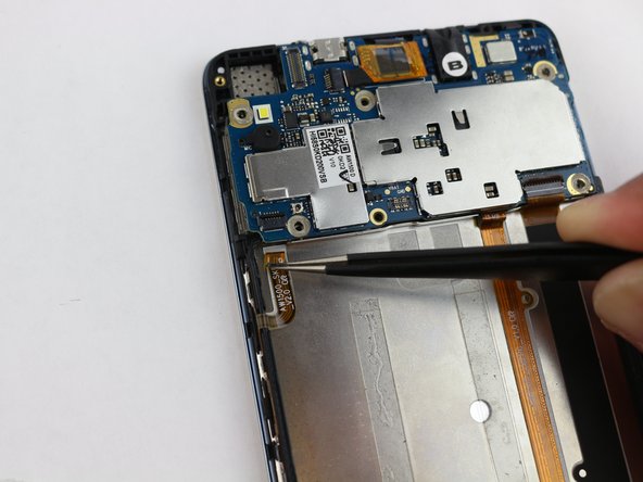

  19. BLU Energy X Plus MotherBoard Replacement: crwdns2935265:019crwdnd2935265:01crwdnd2935265:01crwdne2935265:0

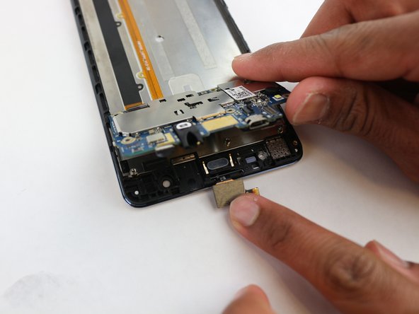

  20. BLU Energy X Plus MotherBoard Replacement: crwdns2935265:020crwdnd2935265:01crwdnd2935265:02crwdne2935265:0 BLU Energy X Plus MotherBoard Replacement: crwdns2935265:020crwdnd2935265:02crwdnd2935265:02crwdne2935265:0
    • Lift the small processor using a pair of tweezers.
    • Then, lift up the motherboard using your hand, lifting from the top of the motherboard.

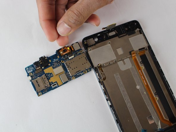

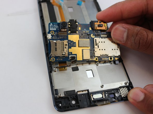

  21. BLU Energy X Plus MotherBoard Replacement: crwdns2935265:021crwdnd2935265:01crwdnd2935265:02crwdne2935265:0 BLU Energy X Plus MotherBoard Replacement: crwdns2935265:021crwdnd2935265:02crwdnd2935265:02crwdne2935265:0
    • Remove the zero insert force connector that's on the back side of the motherboard using a small blue plastic opening tool to lift up the black tab. Then pull the motherboard out of the phone.
    • Pull the motherboard vertically to pull the motherboard from the phone. It should still be attached by a wire on the left side.

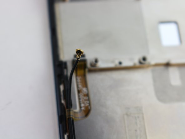

  22. BLU Energy X Plus MotherBoard Replacement: crwdns2935265:022crwdnd2935265:01crwdnd2935265:03crwdne2935265:0 BLU Energy X Plus MotherBoard Replacement: crwdns2935265:022crwdnd2935265:02crwdnd2935265:03crwdne2935265:0 BLU Energy X Plus MotherBoard Replacement: crwdns2935265:022crwdnd2935265:03crwdnd2935265:03crwdne2935265:0
    • Remove the connector wire from the motherboard using your finger nails. You will need to pull from the gold colored connecter, which is attached to the motherboard.
    • And, there's your motherboard.
