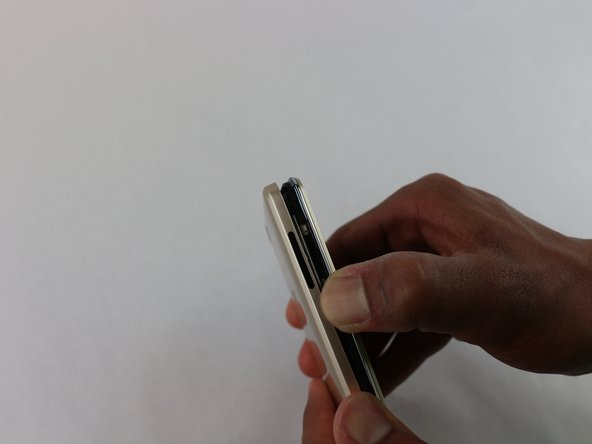

    • Flip your device over so your back cover is facing up.
  4. BLU Energy X Plus Camera Replacement: crwdns2935265:04crwdnd2935265:01crwdnd2935265:02crwdne2935265:0 BLU Energy X Plus Camera Replacement: crwdns2935265:04crwdnd2935265:02crwdnd2935265:02crwdne2935265:0
    • Take the blue plastic opening tool and insert it in-between the back of the phone and the chrome trim. Go all the way around the device slowly to take the back cover off.

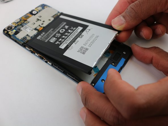

  8. BLU Energy X Plus Camera Replacement: crwdns2935265:08crwdnd2935265:01crwdnd2935265:02crwdne2935265:0 BLU Energy X Plus Camera Replacement: crwdns2935265:08crwdnd2935265:02crwdnd2935265:02crwdne2935265:0
    • Use the small blue plastic opening tool to lift the battery from the bottom with little force because the battery will be glued in.
    • Then, use your hand to remove the battery completely.

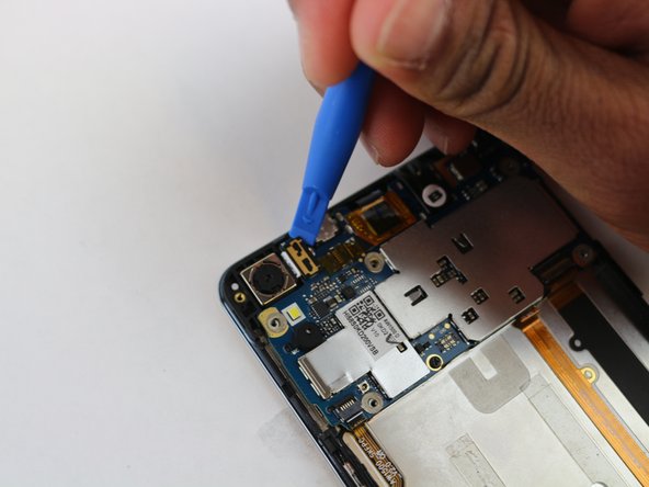

  9. BLU Energy X Plus Camera Replacement, Camera: crwdns2935265:09crwdnd2935265:01crwdnd2935265:02crwdne2935265:0 BLU Energy X Plus Camera Replacement, Camera: crwdns2935265:09crwdnd2935265:02crwdnd2935265:02crwdne2935265:0
    • Disconnect the contact patch using the small blue plastic opening tool.
  10. BLU Energy X Plus Camera Replacement: crwdns2935265:010crwdnd2935265:01crwdnd2935265:01crwdne2935265:0
    • Loosen the camera from the glue using the small blue plastic opening tool.

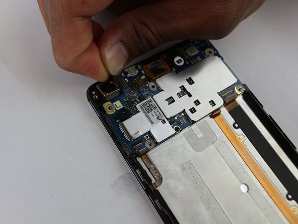

  11. BLU Energy X Plus Camera Replacement: crwdns2935265:011crwdnd2935265:01crwdnd2935265:02crwdne2935265:0 BLU Energy X Plus Camera Replacement: crwdns2935265:011crwdnd2935265:02crwdnd2935265:02crwdne2935265:0
    • After loosening the glue from the bottom of the camera, lift the camera out of the phone.
