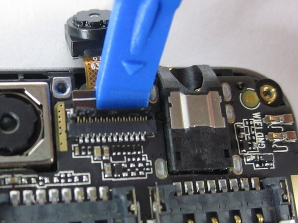

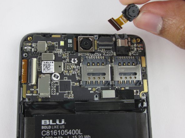

  3. BLU Energy X Front Facing Camera Replacement: crwdns2935265:03crwdnd2935265:01crwdnd2935265:03crwdne2935265:0 BLU Energy X Front Facing Camera Replacement: crwdns2935265:03crwdnd2935265:02crwdnd2935265:03crwdne2935265:0 BLU Energy X Front Facing Camera Replacement: crwdns2935265:03crwdnd2935265:03crwdnd2935265:03crwdne2935265:0
    • Flip up the black retaining flap on the front-facing camera ZIF connector.
    • Gently lift up the motherboard, and pull the front-facing camera free of the device.
