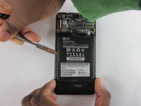

      • Remove the back case using plastic opening tool.
    2. BLU Energy X Battery Replacement: crwdns2935265:02crwdnd2935265:01crwdnd2935265:02crwdne2935265:0 BLU Energy X Battery Replacement: crwdns2935265:02crwdnd2935265:02crwdnd2935265:02crwdne2935265:0
      • Remove the seven 4mm Phillips #000 screws.
      • Remove the top plate.
    3. BLU Energy X Battery Replacement: crwdns2935265:03crwdnd2935265:01crwdnd2935265:03crwdne2935265:0 BLU Energy X Battery Replacement: crwdns2935265:03crwdnd2935265:02crwdnd2935265:03crwdne2935265:0 BLU Energy X Battery Replacement: crwdns2935265:03crwdnd2935265:03crwdnd2935265:03crwdne2935265:0

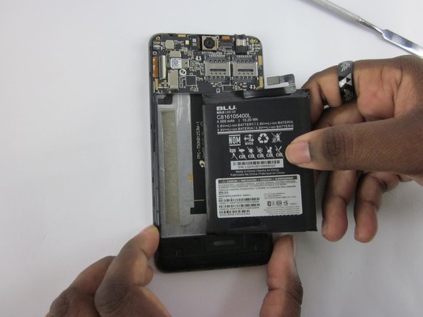

      • Detach the battery from the mother board using a plastic opening tool.
      • Use a plastic spudger to remove battery.

directions were pretty straightforward... mine had a tiny sticker w/ the "B" in BLU printed, covering the screw on the upper left corner that needed removal (warranty?). otherwise, simple replacement...thanks!
