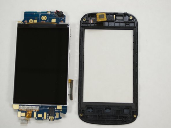

    7. BLU Dash JR D140 Digitizer Replacement: crwdns2935265:09crwdnd2935265:01crwdnd2935265:01crwdne2935265:0
      • Peel off the volume sticky button.
    8. BLU Dash JR D140 Digitizer Replacement: crwdns2935265:010crwdnd2935265:01crwdnd2935265:02crwdne2935265:0 BLU Dash JR D140 Digitizer Replacement: crwdns2935265:010crwdnd2935265:02crwdnd2935265:02crwdne2935265:0
      • Separate the screen cover from the motherboard using the plastic opening tool. And don't forget that your phone can mess up if u separate the motherboard from the screen cover
      • Make sure that the LCD screen stays attached to the motherboard while doing this.
