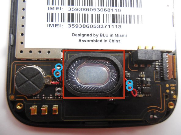

  4. BLU Advance 4.0 Speaker Replacement, Remove the solder on the old speakers: crwdns2935265:04crwdnd2935265:01crwdnd2935265:02crwdne2935265:0 BLU Advance 4.0 Speaker Replacement, Remove the solder on the old speakers: crwdns2935265:04crwdnd2935265:02crwdnd2935265:02crwdne2935265:0
    Desoldering Pump
    $3.99
    • Before starting, you should plug in and begin to heat up your soldering iron.
    • Flip the circuit board over and find the speaker connections to the red and black wires.
    • Take your soldering iron and heat the area where the wires are connected
    • Take your Solder sucker and remove the solder at the connection.
    • Carefully lift the speaker off of the circuit board.
  5. BLU Advance 4.0 Speaker Replacement, Solder in the New Speakers: crwdns2935265:05crwdnd2935265:01crwdnd2935265:01crwdne2935265:0
    • Place the new speaker into the spot where you removed the old speaker.
    • Next, add solder to the tip of your soldering iron.
    • Solder all of the connections back into place as shown.
