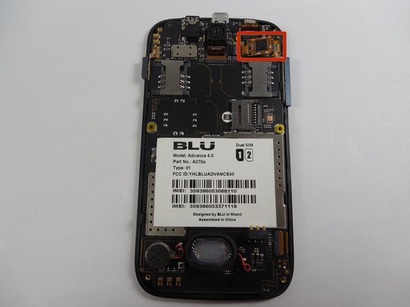

    • The screen connector is located near the back camera and charger port.
    • Remove the attached screen by gently tugging the cord that connects it to main frame.
    • Pull gently to avoid damaging the connected cable.
