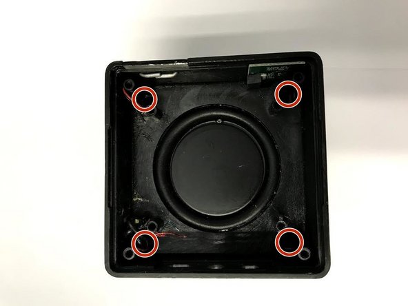

  9. BEM Mojo 2 Speaker Replacement, Speaker: crwdns2935265:09crwdnd2935265:01crwdnd2935265:01crwdne2935265:0
    • Remove any glue that is left over from previous parts that may be covering the screw holes or the speakers drive.

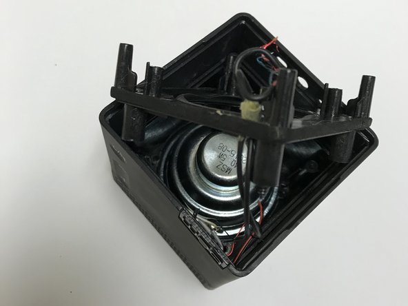

  10. BEM Mojo 2 Speaker Replacement: crwdns2935265:010crwdnd2935265:01crwdnd2935265:02crwdne2935265:0 BEM Mojo 2 Speaker Replacement: crwdns2935265:010crwdnd2935265:02crwdnd2935265:02crwdne2935265:0
    • Remove the speaker's four 10 mm base screws.
  11. BEM Mojo 2 Speaker Replacement: crwdns2935265:011crwdnd2935265:01crwdnd2935265:02crwdne2935265:0 BEM Mojo 2 Speaker Replacement: crwdns2935265:011crwdnd2935265:02crwdnd2935265:02crwdne2935265:0
    • Pry out the speaker's base using the metal Spuger. Use caution upon this step, it will require the use of force.
    • Remove the wire that will be placed in the speakers driver hole for access to the speaker.

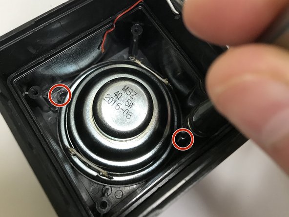

  12. BEM Mojo 2 Speaker Replacement: crwdns2935265:012crwdnd2935265:01crwdnd2935265:02crwdne2935265:0 BEM Mojo 2 Speaker Replacement: crwdns2935265:012crwdnd2935265:02crwdnd2935265:02crwdne2935265:0
    • Remove the speaker's two 10 mm screws that are located in its base then take the driver out of the speaker.
