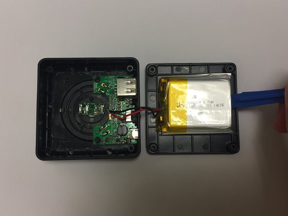

    • Pull the top cover off of the charging base to reveal the internal chip.
    • Use the plastic opening tool to pry the battery from the top cover.
    • Caution: Be careful when detaching battery from top cover as to not damage any of the wires attached to it.
  4. BEM Mojo 2 Charging Base Motherboard Replacement: crwdns2935265:04crwdnd2935265:01crwdnd2935265:01crwdne2935265:0
    • Use the tweezers to carefully detach the wires from the internal chip.
    • Caution: Be careful to not damage the internal chip when removing the wires.
  5. BEM Mojo 2 Charging Base Motherboard Replacement, Charging Base Motherboard: crwdns2935265:05crwdnd2935265:01crwdnd2935265:01crwdne2935265:0
    • Use the tweezers to remove the red wire attached to the motherboard.
  6. BEM Mojo 2 Charging Base Motherboard Replacement: crwdns2935265:06crwdnd2935265:01crwdnd2935265:01crwdne2935265:0
    • Use the plastic opening tool to carefully lift and remove the motherboard from the charging base.
