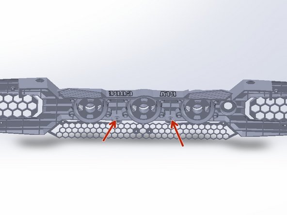

      • Start by placing the NeoPixel rings into the circles. Make sure the pins are at the top center.
      • Thread the Inner Fan part into the circle.
      • Thread the tip into the Inner Fan.
    2. B. Front Panel, Front Panel Assembly: crwdns2935265:02crwdnd2935265:01crwdnd2935265:02crwdne2935265:0 B. Front Panel, Front Panel Assembly: crwdns2935265:02crwdnd2935265:02crwdnd2935265:02crwdne2935265:0
      • Screw the assembled Circle parts into the Front Face using 12x M3x8 countersunk screws
    3. B. Front Panel, Front Panel Assembly: crwdns2935265:03crwdnd2935265:01crwdnd2935265:03crwdne2935265:0 B. Front Panel, Front Panel Assembly: crwdns2935265:03crwdnd2935265:02crwdnd2935265:03crwdne2935265:0 B. Front Panel, Front Panel Assembly: crwdns2935265:03crwdnd2935265:03crwdnd2935265:03crwdne2935265:0

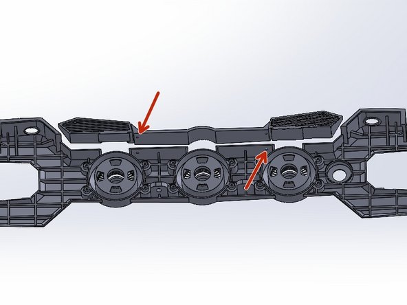

      • Glue the letters into the Middle Name Plate

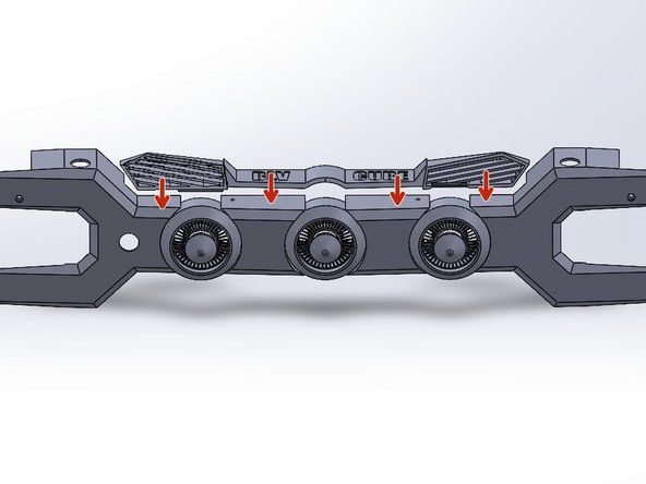

      • Slide in the Middle Name Plate, Left and Right Nets into the Assembled Front Panel
      • Using 2x M3x8 button head screws secure the Middle Name Plate to the Assembled Front Panel.
    4. B. Front Panel, Front Panel Assembly: crwdns2935265:04crwdnd2935265:01crwdnd2935265:01crwdne2935265:0
      • Slide in the Left and Right Grill into the Front Panel Assembly
    5. B. Front Panel, Front Panel Mounting: crwdns2935265:05crwdnd2935265:01crwdnd2935265:02crwdne2935265:0 B. Front Panel, Front Panel Mounting: crwdns2935265:05crwdnd2935265:02crwdnd2935265:02crwdne2935265:0

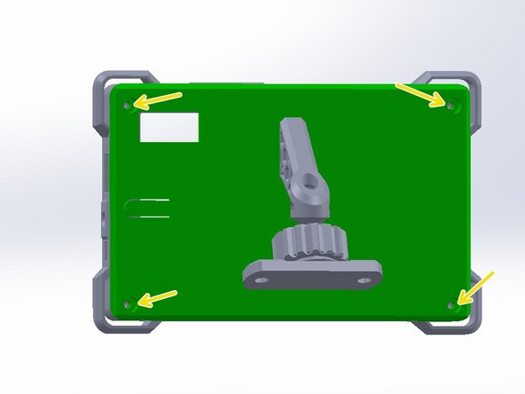

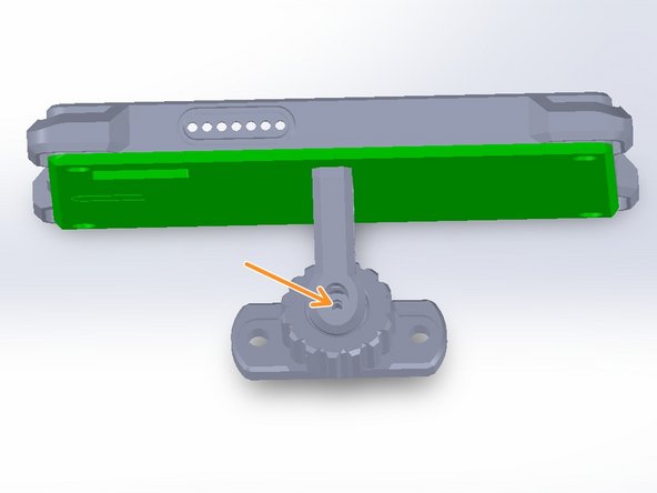

    6. B. Front Panel, LCD: crwdns2935265:06crwdnd2935265:01crwdnd2935265:03crwdne2935265:0 B. Front Panel, LCD: crwdns2935265:06crwdnd2935265:02crwdnd2935265:03crwdne2935265:0 B. Front Panel, LCD: crwdns2935265:06crwdnd2935265:03crwdnd2935265:03crwdne2935265:0
      • Mount the backplate to the arm with 2x M3x8 button head screws.
      • Mount the ball to the arm with 1x M3x8 socket head screw.
      • I also used a drop of superglue.
      • Insert the PanelDue into the backplate lining up the screw holes. Screw the backplate to the front plate with 4x M3x10 button head screws.
      • Mount the full assembly to the front frame re-enforcement with 2x M5x10 button head screws and 2x M5 T-nuts

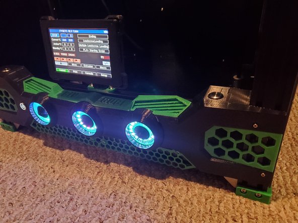

    7. B. Front Panel, Results: crwdns2935265:07crwdnd2935265:01crwdnd2935265:02crwdne2935265:0 B. Front Panel, Results: crwdns2935265:07crwdnd2935265:02crwdnd2935265:02crwdne2935265:0
      • Looks pretty cool huh?
