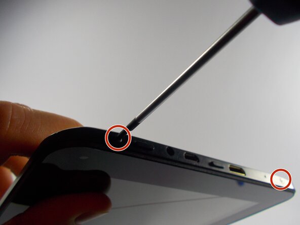

    • Begin by unscrewing the two 1.4 mm diameter Phillips #00 head screws at the top of the device.
