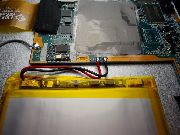

    1. Azpen A909 Battery Replacement, Battery: crwdns2935265:04crwdnd2935265:01crwdnd2935265:02crwdne2935265:0 Azpen A909 Battery Replacement, Battery: crwdns2935265:04crwdnd2935265:02crwdnd2935265:02crwdne2935265:0
      • Remove the tape located at the end of the battery carefully
      • Do not rip the tape off too fast, as you could damage the red and black wires connecting the battery to the device
    2. Azpen A909 Battery Replacement: crwdns2935265:05crwdnd2935265:01crwdnd2935265:01crwdne2935265:0
      • Using a plastic opening tool, gently pry the edges battery off of the backside of the touchscreen display. Start at the end of the battery opposite the connecting wires.
      • Once the edges are free, slowly work inward with the opening tool until the battery is free. This may take some time, since copious amounts of adhesive were used to anchor the battery in place.
      • Be careful not to damage the wires connecting the battery to the circuit board or the touchscreen underneath the battery.
    3. Azpen A909 Battery Replacement: crwdns2935265:06crwdnd2935265:01crwdnd2935265:01crwdne2935265:0
      • If you are new to soldering, it's a good idea to check out iFixit's soldering and desoldering guide.
      • Pick a connection point and place the soldering iron on top of the wick above the existing solder ball.
      • Hold the soldering iron in place until the solder melts into the wick.
      • Repeat the same procedure on the remaining connector.
      • Lift the old battery off of the touchscreen. Make sure that all the solder has been removed before pulling the wires away from the board. The wires should come free with little to no resistance.
      • When soldering the lead connections for the new battery, take special care not to solder the two connectors together.
