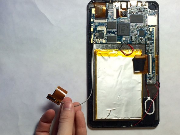

  4. Azpen A740 Screen Replacement: crwdns2935265:04crwdnd2935265:01crwdnd2935265:01crwdne2935265:0
    • With the plastic now removed from the camera, the user is able to unclip the camera from the motherboard by pulling up the black clip and sliding out the camera.
    • Here you can see the rear camera is on the top and the front camera is on the top. As you can see, it is not possible to replace one camera and not the other.
  5. Azpen A740 Screen Replacement: crwdns2935265:05crwdnd2935265:01crwdnd2935265:01crwdne2935265:0
    • This is what the camera looks like once completely removed from the tablet.
    • This is where the camera was previously, it is the place where the new camera must be placed.

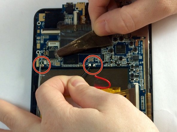

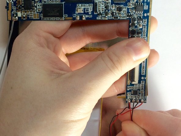

    • Now comes the desoldering. If you have never done this before, you may want to read this: How To Solder and Desolder Connections
    • In all, there should be 7 wires that need to be desoldered: 2 that are connected to the speaker, 2 that are connected to the screen, 2 that are directly connected to the battery and 1 that is connected to a thick wire that feeds into a sticker on the battery.
  12. Azpen A740 Screen Replacement: crwdns2935265:012crwdnd2935265:01crwdnd2935265:01crwdne2935265:0
    • Once all connections are removed from the motherboard, it is able to be removed by gently placing the plastic opening tool under the motherboard and lifting up the motherboard from the bottom of the screen.
    • To reassemble your device, follow these instructions in reverse order.

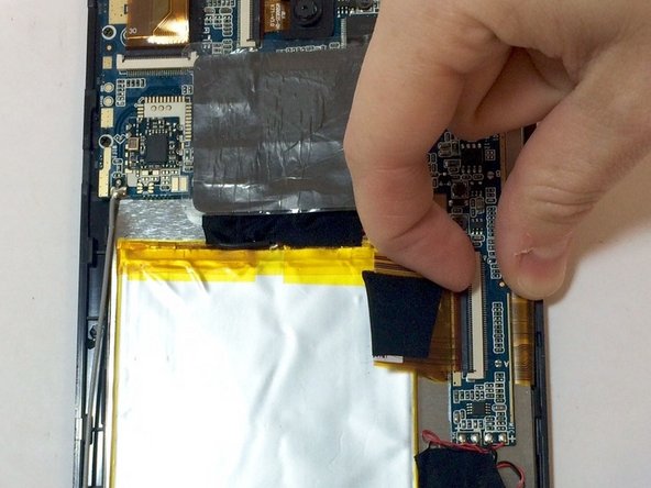

  13. Azpen A740 Screen Replacement, Battery: crwdns2935265:013crwdnd2935265:01crwdnd2935265:02crwdne2935265:0 Azpen A740 Screen Replacement, Battery: crwdns2935265:013crwdnd2935265:02crwdnd2935265:02crwdne2935265:0
    • Use the set of plastic opening tools to separate the inner backing from the electronics.
    • Use the Phillips screwdriver to remove the 3.8 mm screws, holding the inner backing of Azpen A740 Tablet.
  14. Azpen A740 Screen Replacement: crwdns2935265:014crwdnd2935265:01crwdnd2935265:01crwdne2935265:0
    • Disconnect the black, red, and grey wires leading to the battery from the motherboard using a soldering iron.
    • In order to desolder these connections follow the instructions on IFixit's How to Solder and Desolder Connections
  15. Azpen A740 Screen Replacement: crwdns2935265:015crwdnd2935265:01crwdnd2935265:02crwdne2935265:0 Azpen A740 Screen Replacement: crwdns2935265:015crwdnd2935265:02crwdnd2935265:02crwdne2935265:0
    • Remove the black tape that is holding the battery in place.
