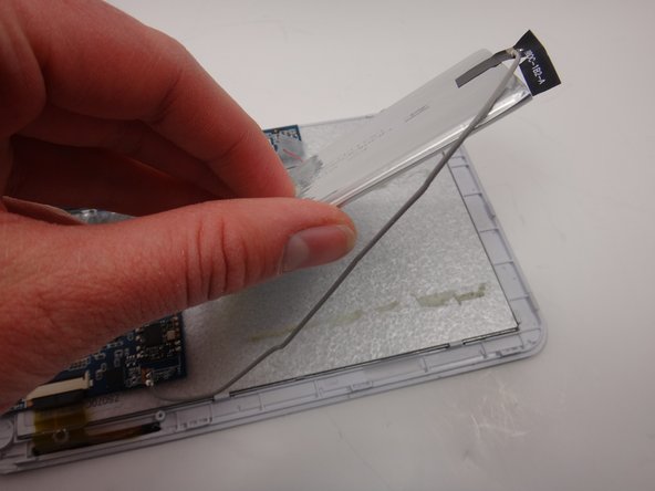

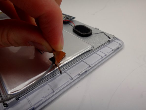

    3. Azpen A720 Battery Replacement: crwdns2935265:06crwdnd2935265:01crwdnd2935265:02crwdne2935265:0 Azpen A720 Battery Replacement: crwdns2935265:06crwdnd2935265:02crwdnd2935265:02crwdne2935265:0
      • Peel the black sticker off the battery to disconnect the wifi antennae.

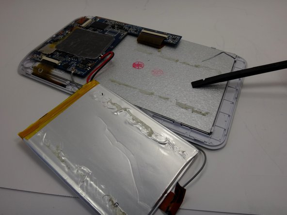

    4. Azpen A720 Battery Replacement: crwdns2935265:07crwdnd2935265:01crwdnd2935265:03crwdne2935265:0 Azpen A720 Battery Replacement: crwdns2935265:07crwdnd2935265:02crwdnd2935265:03crwdne2935265:0 Azpen A720 Battery Replacement: crwdns2935265:07crwdnd2935265:03crwdnd2935265:03crwdne2935265:0
      • Slide the spudger between the battery and the metal backing. Move the spudger back and forth in a sawing motion to break the adhesive seal between the battery and the backing.
      • When the spudger is underneath the battery avoid prying. A prying motion could damage the battery.
    5. Azpen A720 Battery Replacement: crwdns2935265:08crwdnd2935265:01crwdnd2935265:02crwdne2935265:0 Azpen A720 Battery Replacement: crwdns2935265:08crwdnd2935265:02crwdnd2935265:02crwdne2935265:0
      • Remove the old battery and replace it with the new battery.
