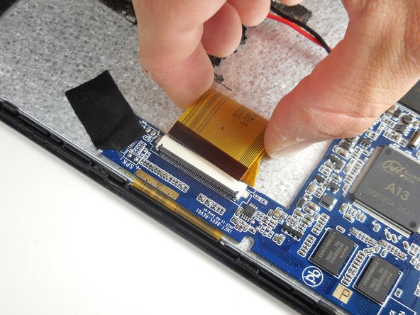

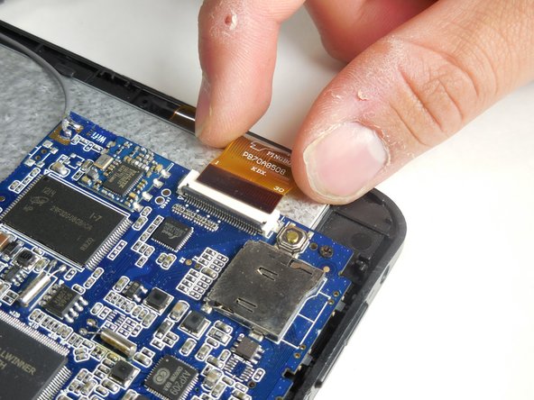

    • Disconnect the two largest (of the three) ZIF cables by prying open the flap with a plastic spudger to gently remove them.

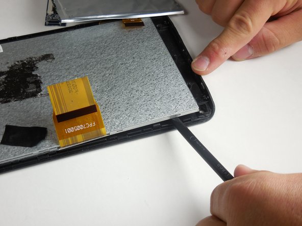

    • Remove the small orange tape attached with a gray wire from the top corner of the device. This is the antenna.

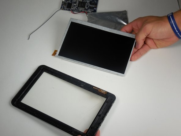

    • Use a plastic spudger around the silver lining within the device to pry the screen off.
    • The metal screen assembly is two pieces. When removing the screen, make sure to pry off both pieces at once.
  10. Azpen A701 Screen Replacement: crwdns2935265:010crwdnd2935265:01crwdnd2935265:01crwdne2935265:0
    • Replace the broken screen and reverse the steps to re-assemble the device.
