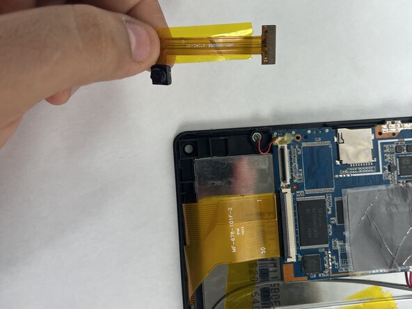

  2. Azpen A1045 Camera Replacement, Camera: crwdns2935265:02crwdnd2935265:01crwdnd2935265:01crwdne2935265:0
    • Start by locating the camera, which is directly above the battery if you are holding the tablet front side up.
  3. Azpen A1045 Camera Replacement: crwdns2935265:03crwdnd2935265:01crwdnd2935265:01crwdne2935265:0
    • Using your iFixit opening tool, gently lift the black tab holding the orange ribbon cable.
    • This will unlock the cable so you can safely slide it out without damage.
    • Be careful not to use too much force, as the tab can break easily.
  4. Azpen A1045 Camera Replacement: crwdns2935265:04crwdnd2935265:01crwdnd2935265:02crwdne2935265:0 Azpen A1045 Camera Replacement: crwdns2935265:04crwdnd2935265:02crwdnd2935265:02crwdne2935265:0
    • Remove the camera from the tablet.
