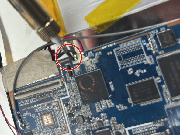

  2. Azpen A1045 Battery Replacement, Battery: crwdns2935265:02crwdnd2935265:01crwdnd2935265:02crwdne2935265:0 Azpen A1045 Battery Replacement, Battery: crwdns2935265:02crwdnd2935265:02crwdnd2935265:02crwdne2935265:0
    • After heating your soldering iron, place it on the black wire and desolder it.
    • Repeat the same step for the red wire.
    • For more information on soldering, check out this guide.

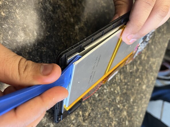

  3. Azpen A1045 Battery Replacement: crwdns2935265:03crwdnd2935265:01crwdnd2935265:02crwdne2935265:0 Azpen A1045 Battery Replacement: crwdns2935265:03crwdnd2935265:02crwdnd2935265:02crwdne2935265:0
    • Warning: Be careful not to puncture the battery, as doing so could cause it to explode.
    • Insert an iFixit opening tool beneath the battery and gently pry it up.
    • If you're having trouble removing the adhesive, use 91% or higher isopropyl alcohol. Apply it in small quantities with a syringe, if possible, to avoid damaging any electrical components.
    • After removing the battery, clean the area where the adhesive was, so it's ready for the new battery.
