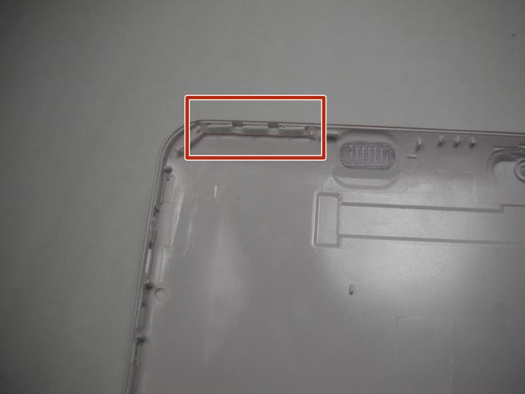

    • Orient the tablet's back cover so that the inside faces up and the buttons are positioned at the top left corner.

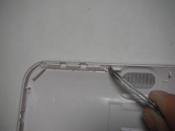

    • Unlatch the clear rubber holder from the posts with the tweezers.

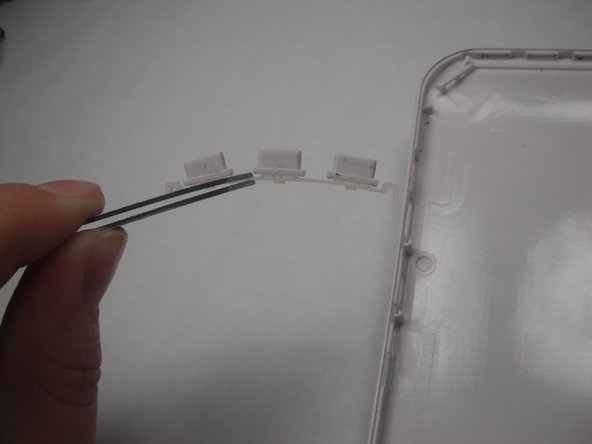

    • With tweezers, pull the rubber holder from the back cover completely.

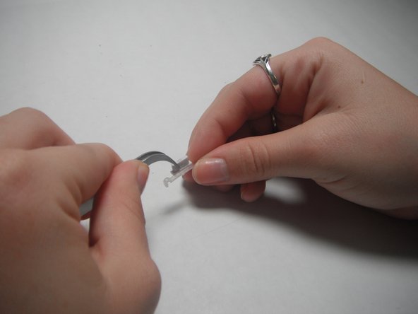

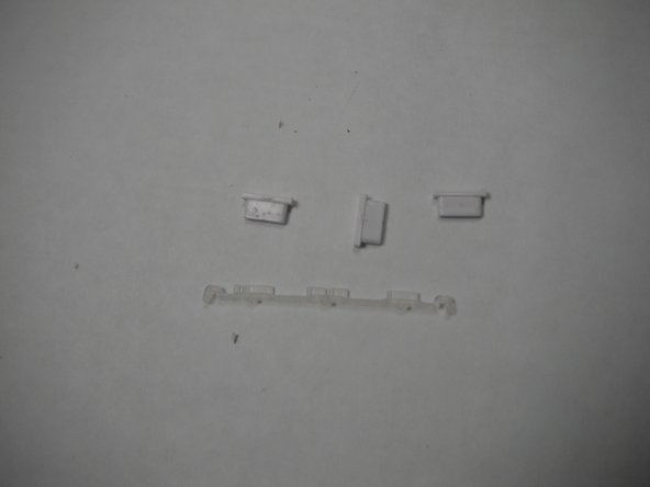

    • Remove the individual buttons with tweezers.
