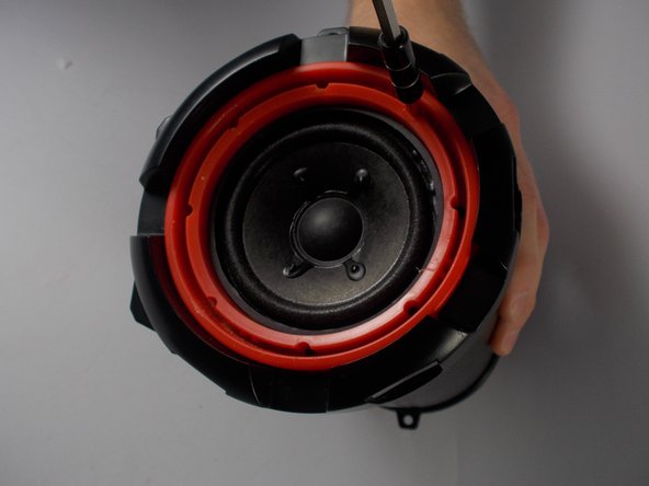

      • Use a metal spudger to remove the mesh speaker cover by wedging the narrow end into the center of the outer edge of the mesh touching the red plate.
    3. Axess SPBT1031 Subwoofer Replacement: crwdns2935265:03crwdnd2935265:01crwdnd2935265:02crwdne2935265:0 Axess SPBT1031 Subwoofer Replacement: crwdns2935265:03crwdnd2935265:02crwdnd2935265:02crwdne2935265:0
      • Remove four 5.5 mm screws from the red panel under the mesh using a Phillips #1 screwdriver.
      • For subwoofer replacement there will be four screws to remove and four bolts as well. The bolts are used for alignment and cannot be removed.
    4. Axess SPBT1031 Subwoofer Replacement: crwdns2935265:04crwdnd2935265:01crwdnd2935265:01crwdne2935265:0
      • If the screws are difficult to remove, use the tweezers to twist and pick them out.

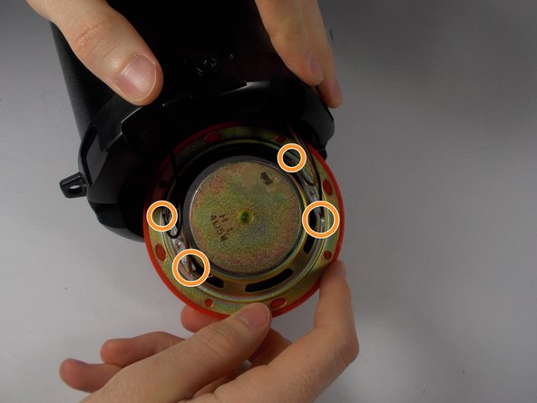

    6. Axess SPBT1031 Subwoofer Replacement: crwdns2935265:06crwdnd2935265:01crwdnd2935265:02crwdne2935265:0 Axess SPBT1031 Subwoofer Replacement: crwdns2935265:06crwdnd2935265:02crwdnd2935265:02crwdne2935265:0
      • To remove the the wires from the subwoofer terminals, use a soldering iron to reheat the solder at each of the four points of connection.
    7. Axess SPBT1031 Subwoofer Replacement: crwdns2935265:07crwdnd2935265:01crwdnd2935265:01crwdne2935265:0
      Desoldering Pump
      $3.99
    8. Axess SPBT1031 Subwoofer Replacement: crwdns2935265:08crwdnd2935265:01crwdnd2935265:01crwdne2935265:0
      • Remove the old subwoofer.
      • Connect the brown wires to the positive terminals and the black ones to the negative terminals when re-soldering.
