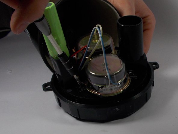

  4. Axess SPBT1031 Speaker (Horns) Replacement: crwdns2935265:04crwdnd2935265:01crwdnd2935265:02crwdne2935265:0 Axess SPBT1031 Speaker (Horns) Replacement: crwdns2935265:04crwdnd2935265:02crwdnd2935265:02crwdne2935265:0
    • To remove the plastic coating around the desired horn, look on the back of the black face plate you removed and use the philips head ph1 screwdriver fitting to remove the two 0.3 cm Philips Head screw and washer combos on the left and right of the horn.
    • Screw depth of 0.7 cm
  5. Axess SPBT1031 Speaker (Horns) Replacement: crwdns2935265:05crwdnd2935265:01crwdnd2935265:01crwdne2935265:0
    • Lift the horn from its fitting by pulling it. Position it in a manner that is easy to work with.

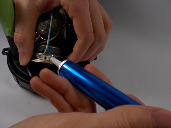

  6. Axess SPBT1031 Speaker (Horns) Replacement: crwdns2935265:06crwdnd2935265:01crwdnd2935265:02crwdne2935265:0 Axess SPBT1031 Speaker (Horns) Replacement: crwdns2935265:06crwdnd2935265:02crwdnd2935265:02crwdne2935265:0
    Desoldering Pump
    $3.99
    • Use a soldering iron to heat the two contact points.
    • Then use a desoldering pump to remove the liquid solder.
  7. Axess SPBT1031 Speaker (Horns) Replacement: crwdns2935265:07crwdnd2935265:01crwdnd2935265:01crwdne2935265:0
    • Remove the wires--blue or yellow wire depending on the horn you are replacing--from the old speaker and remove the speaker from the fitting location.
