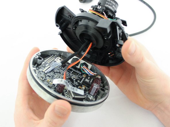

    1. AvertX HD810 PoE Cable Replacement, PoE Cable: crwdns2935265:04crwdnd2935265:01crwdnd2935265:03crwdne2935265:0 AvertX HD810 PoE Cable Replacement, PoE Cable: crwdns2935265:04crwdnd2935265:02crwdnd2935265:03crwdne2935265:0 AvertX HD810 PoE Cable Replacement, PoE Cable: crwdns2935265:04crwdnd2935265:03crwdnd2935265:03crwdne2935265:0

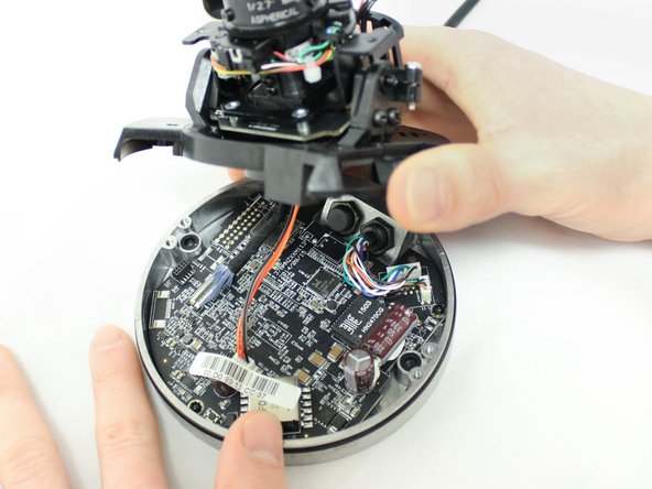

      • Make sure the device is turned off and unplugged completely before attempting any more disassembly .
      • Unscrew the two 10mm screws holding the plastic camera base to the metal camera base using the PH1 screwdriver.
      • Be aware that cables are still connected under this base, and gently lift the plastic base with the camera away from the metal base with the motherboard.
    2. AvertX HD810 PoE Cable Replacement: crwdns2935265:05crwdnd2935265:01crwdnd2935265:03crwdne2935265:0 AvertX HD810 PoE Cable Replacement: crwdns2935265:05crwdnd2935265:02crwdnd2935265:03crwdne2935265:0 AvertX HD810 PoE Cable Replacement: crwdns2935265:05crwdnd2935265:03crwdnd2935265:03crwdne2935265:0

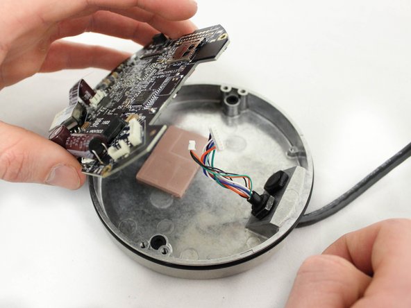

      • Disconnect the two cables from the camera base motherboard by gently but firmly pulling directly away from their respective ports.
      • Disconnect the two PoE (Power over Ethernet) cables from the motherboard by gently but firmly pulling the connected cables directly away from their respective ports.
    3. AvertX HD810 PoE Cable Replacement: crwdns2935265:06crwdnd2935265:01crwdnd2935265:03crwdne2935265:0 AvertX HD810 PoE Cable Replacement: crwdns2935265:06crwdnd2935265:02crwdnd2935265:03crwdne2935265:0 AvertX HD810 PoE Cable Replacement: crwdns2935265:06crwdnd2935265:03crwdnd2935265:03crwdne2935265:0

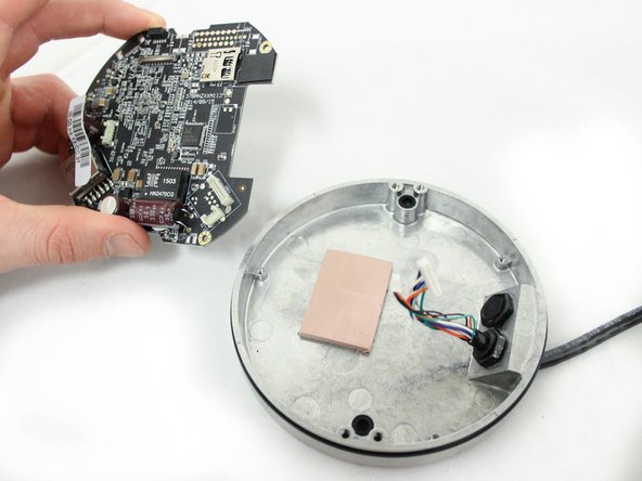

      • Using a nonmagnetic, PH000 Phillips Head screwdriver, remove the three 6mm screws that hold the motherboard to the metal base.
      • Set the motherboard aside on a non-static surface.
    4. AvertX HD810 PoE Cable Replacement: crwdns2935265:07crwdnd2935265:01crwdnd2935265:03crwdne2935265:0 AvertX HD810 PoE Cable Replacement: crwdns2935265:07crwdnd2935265:02crwdnd2935265:03crwdne2935265:0 AvertX HD810 PoE Cable Replacement: crwdns2935265:07crwdnd2935265:03crwdnd2935265:03crwdne2935265:0

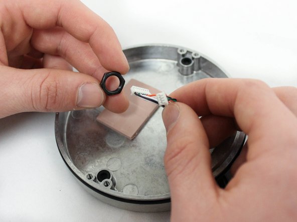

      • Remove the 1/2" hex nut holding the cable in place to the metal base with a 1/2" open-ended wrench.
    5. AvertX HD810 PoE Cable Replacement: crwdns2935265:08crwdnd2935265:01crwdnd2935265:02crwdne2935265:0 AvertX HD810 PoE Cable Replacement: crwdns2935265:08crwdnd2935265:02crwdnd2935265:02crwdne2935265:0

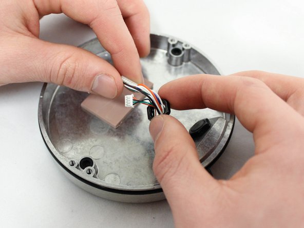

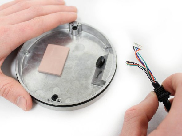

      • Pull the PoE cable away from the metal camera base while angling the plastic connectors through the hole
