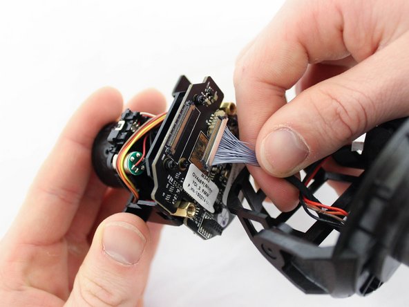

  6. AvertX HD810 Motherboard Replacement, 4 MP Camera: crwdns2935265:06crwdnd2935265:01crwdnd2935265:03crwdne2935265:0 AvertX HD810 Motherboard Replacement, 4 MP Camera: crwdns2935265:06crwdnd2935265:02crwdnd2935265:03crwdne2935265:0 AvertX HD810 Motherboard Replacement, 4 MP Camera: crwdns2935265:06crwdnd2935265:03crwdnd2935265:03crwdne2935265:0
    • Using a PH1 screwdriver, remove the two 8mm screws holding the plastic base to the metal base of the camera.
    • Be sure to keep track of your screws and washers. Using the correct Phillips Head screwdriver will help prevent stripping the screws.
    • Careful when lifting the plastic base away from the metal base. There are two chords that may be damaged if pulled on.

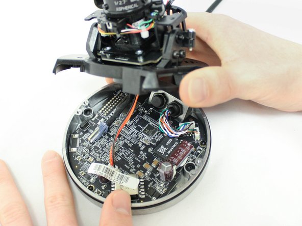

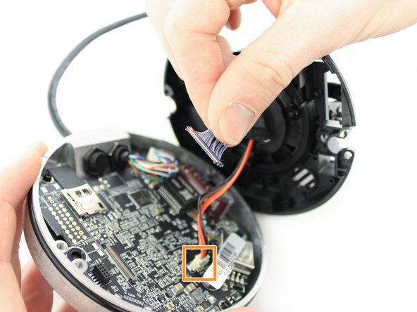

  7. AvertX HD810 Motherboard Replacement: crwdns2935265:07crwdnd2935265:01crwdnd2935265:03crwdne2935265:0 AvertX HD810 Motherboard Replacement: crwdns2935265:07crwdnd2935265:02crwdnd2935265:03crwdne2935265:0 AvertX HD810 Motherboard Replacement: crwdns2935265:07crwdnd2935265:03crwdnd2935265:03crwdne2935265:0
    • Disconnect the two cables from the camera base motherboard by gently but firmly pulling directly away from their respective ports.
  8. AvertX HD810 Motherboard Replacement: crwdns2935265:08crwdnd2935265:01crwdnd2935265:03crwdne2935265:0 AvertX HD810 Motherboard Replacement: crwdns2935265:08crwdnd2935265:02crwdnd2935265:03crwdne2935265:0 AvertX HD810 Motherboard Replacement: crwdns2935265:08crwdnd2935265:03crwdnd2935265:03crwdne2935265:0

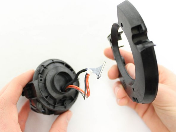

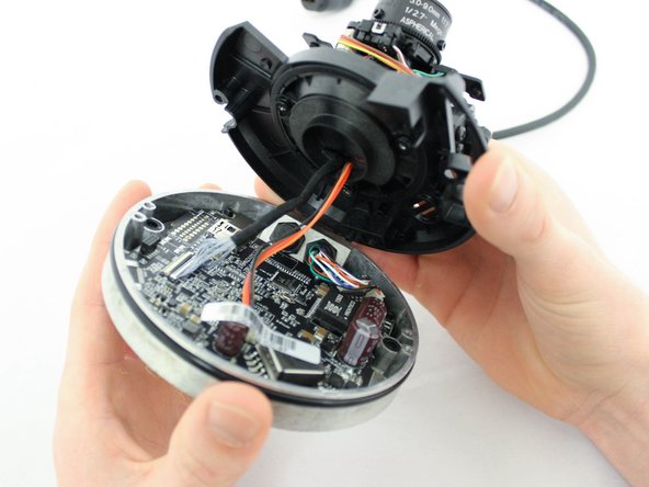

  9. AvertX HD810 Motherboard Replacement: crwdns2935265:09crwdnd2935265:01crwdnd2935265:02crwdne2935265:0 AvertX HD810 Motherboard Replacement: crwdns2935265:09crwdnd2935265:02crwdnd2935265:02crwdne2935265:0

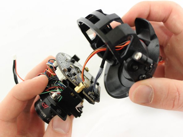

    • Gently tilt the camera forward in the cradle of the camera housing to get access to the two 10m screws.
    • Use a PH1 screwdriver to remove the two 10mm screws.

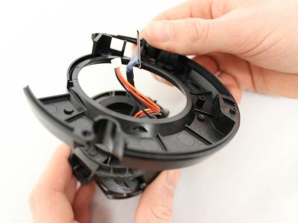

    • Pull away the camera housing once the screws have been removed.
  10. AvertX HD810 Motherboard Replacement: crwdns2935265:010crwdnd2935265:01crwdnd2935265:02crwdne2935265:0 AvertX HD810 Motherboard Replacement: crwdns2935265:010crwdnd2935265:02crwdnd2935265:02crwdne2935265:0
    • Remove the two cables gently but firmly by pulling directly away from their respective ports.
    • The camera housing will always stay attached to these cables. They should not be removed from this housing.

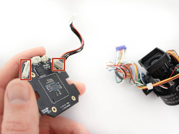

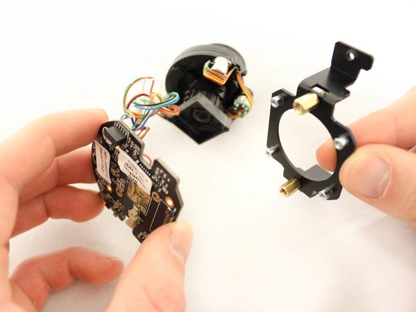

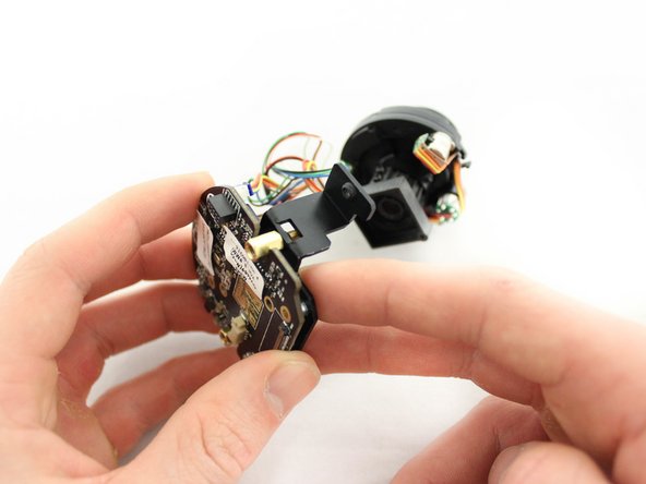

  11. AvertX HD810 Motherboard Replacement, Motherboard: crwdns2935265:011crwdnd2935265:01crwdnd2935265:03crwdne2935265:0 AvertX HD810 Motherboard Replacement, Motherboard: crwdns2935265:011crwdnd2935265:02crwdnd2935265:03crwdne2935265:0 AvertX HD810 Motherboard Replacement, Motherboard: crwdns2935265:011crwdnd2935265:03crwdnd2935265:03crwdne2935265:0
    • Do not use a magnetic screwdriver or drill bits on the camera's motherboard. This can damage the camera's motherboard.
    • Use a PH000 screwdriver to unscrew the four 4mm screws that hold the motherboard to the motherboard housing. These will be the raised screws with safety washers.
    • Use a PH000 screwdriver to unscrew the two 3mm screws that hold the motherboard to the camera. These are smaller screws that have no washers and are not raised.
    • Pull the motherboard mounting away from the motherboard after unscrewing the motherboard from the camera.

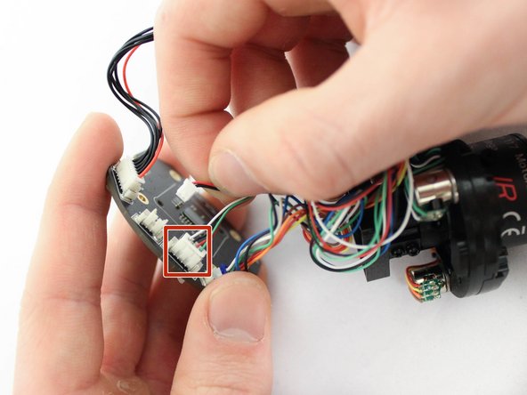

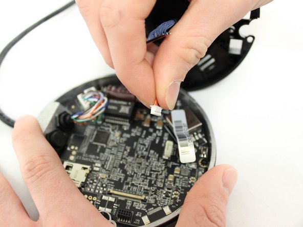

  12. AvertX HD810 Motherboard Replacement: crwdns2935265:012crwdnd2935265:01crwdnd2935265:03crwdne2935265:0 AvertX HD810 Motherboard Replacement: crwdns2935265:012crwdnd2935265:02crwdnd2935265:03crwdne2935265:0 AvertX HD810 Motherboard Replacement: crwdns2935265:012crwdnd2935265:03crwdnd2935265:03crwdne2935265:0
    • Disconnect the three cables from the motherboard by pulling each one gently but firmly away from their respective connections.
    • All of these cables can safely be removed from the motherboard.
