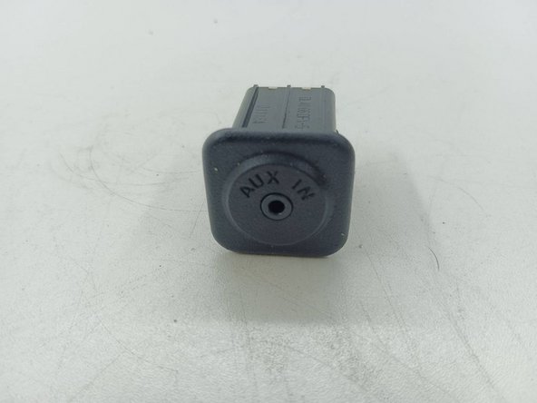

    • The auxiliary input is in a plastic housing that needs to be pried out, and it does not come out easily. A small pry tool or flathead screwdriver will suffice, but it will require some time to free the clips on the sides of the housing.
    • There are small clips on either two sides of the housing, a few millimeters from the edge on either side. A metal pry tool was the most effective, as slightly bending the plastic around the housing seems necessary.
    • Once the plastic housing is free, the connection can be removed by pushing down the central tab on the plug.
    • To remove the circuit board, loosen the externally-visible clips with a small pry tool and pull it out of the housing.
    • The circuit board will have (from top to bottom) two Phillips screws, six small solder points, one solder point, two solder points, four solder points, and two solder points. The important row is the one with six solder points.
    • With the Phillips screws at the top, the pins to solder together are the two leftmost pins. Be careful to ensure that no other pins are bridged, as damage could occur to your stereo.
    • Be sure to test your solder job before reassembly by plugging the circuit board back into the car and testing it.
